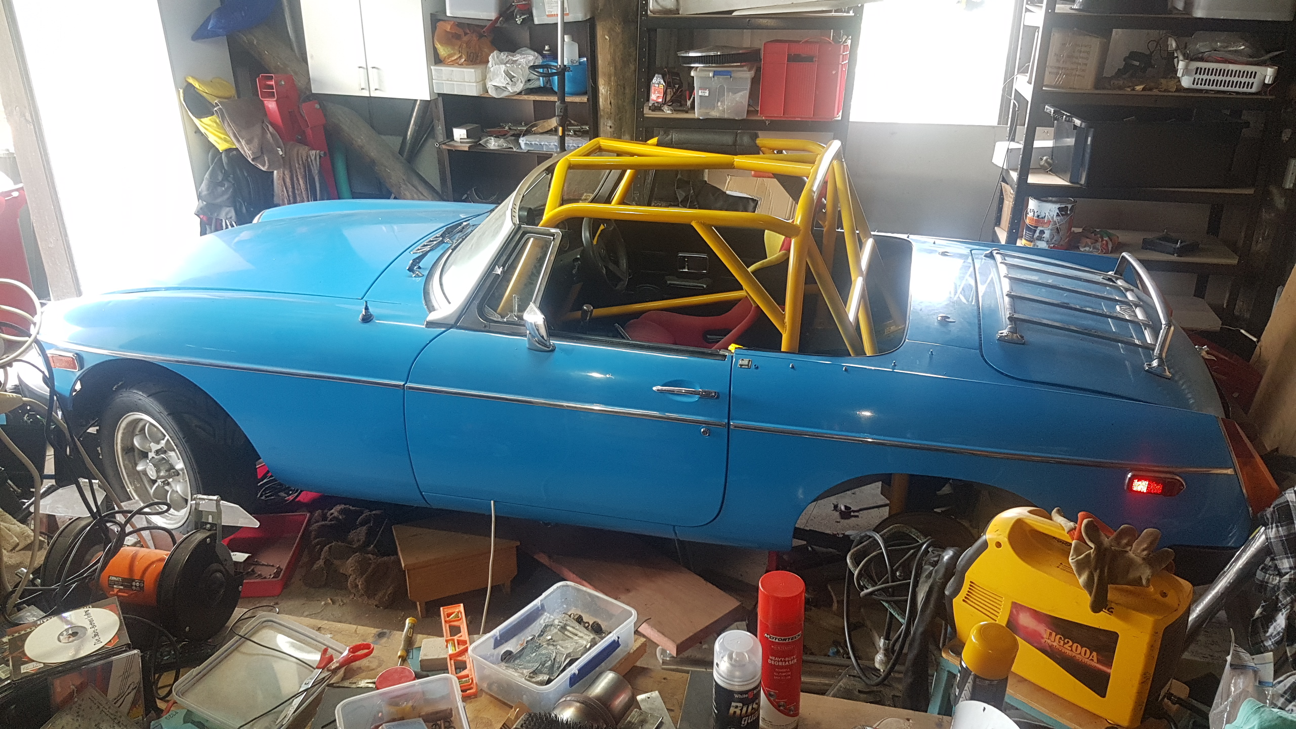

Post by Bman new zealand » Fri Feb 28, 2020 7:19 pm
Roll cage all finnished

Post by steve00136 » Mon Mar 09, 2020 11:13 pm
That's one awesome roll cage !!!! Think next you want to tidy up that garage.
