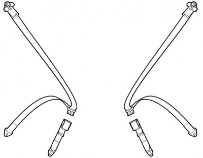

Not much use to you I suppose, butI have this kind of classic belt, fitted from new. No problem of the kind you have encountered.

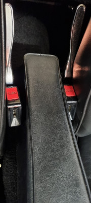

Re: Seat belt receiver position on GT ?
The receiver stacks are a tight fit between the side of the seat & the transmission. The receiver socket sits under the adjustment leaver - see attached.
(I replaced my original deck chair style dressed seats with leather on same style frames).
Cheers, Charles
Cheers, Charles
- Posts: 414
Thanks Charles. That is just what i needed

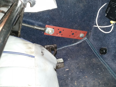

I extended my stalks with a piece of stout flat steel bar about 4 inches long. I mean I bolted the steel to the belt mounting point and then used some proper seat belt bolts and nuts to attach the stalk to the bar. Makes a world of difference to the fit of the belt round your hips. It helps a bit with tipping the seat forward, but the belt socket still gets in the way. The rigid belt stalk really doesn't suit the MGB's tight cabin. A socket attached with belt webbing would work much better, as in Ian's post. But I like to have the inertia reel.
- Posts: 414
That adaption, moving the bolt point forward sounds really good.
Here is a photo of what I did. The steel bar is from Toolstation (https://www.toolstation.com/dual-coated ... ate/p14127). It is 3mm thick so is well able to take any loading that might be put on it. I had to slightly enlarge the holes to suit the belt bolts.
