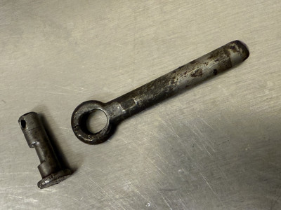

When my clutch showed the same signs, as well as the hose ballooning when the pedal was pressed, the clevis pin and push-rod looked like this. There shouldn't be a groove in the pin, and the hole in the rod started life circular. Easily 5mm of lost movement there alone. Good luck!

If the rod and pin has wear this would be a gradual loss in movement I presume? My clutch operation happened within 30 minutes driving, ballooning pipe I can belive along with failed slave. I may just call RAC out as i have full coverage to see what they say until i have full movement in my back again

How about if the clevis pin, push rod and hose have all aged over time, with the first two wearing incrementally but not enough to be noticed and the hose weakening but not distorting. You're still able to disengage the clutch/get into gear. And then suddenly you can't. If it is indeed 'sudden' it sounds as though the hose might well have been the critical/final change. That's nowhere near the same as saying the hose is the only part in need of attention/replacement.
It's a widespread mistake to think a or b or c is causing a failure, when it's often a and b and c.
