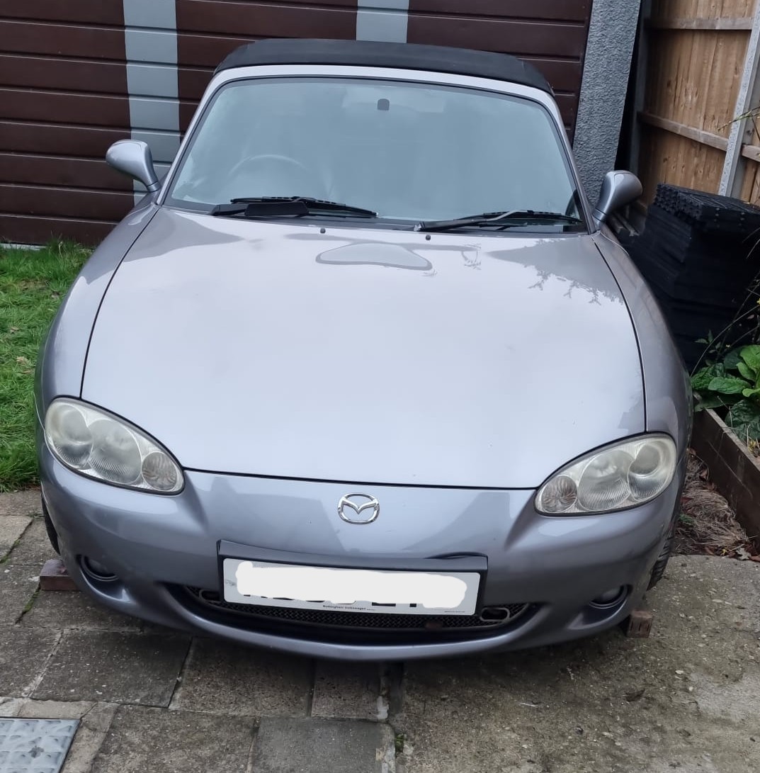

Ive sucessfully bid on a low mileage MOT failure MX5 which will be donating its engine and gearbox to my B GT.
This will be a far less ambitious engine swap than MGB281's highly sophiosticated Jaguar V6 & RX8 gearbox transplant. Though there will be elements of fabricating and adapting some parts and problem solving on the fly, I have to confess this will be largely following a path laid down by others.
The plan is to use as many stock parts as I can including the injection system and ECU and then to document anything that has had to be modified. The rationale being that any future owner will be able to readily replace most parts with off the shelf MGB and MX5 parts (+MGF for the steering) and be able to replicate any parts Ive modified for the conversion..

The MX5 donor car has now arrived and at only 67,000 miles, it's VVT engine runs very nicely and the car is only let down by rust underneath.

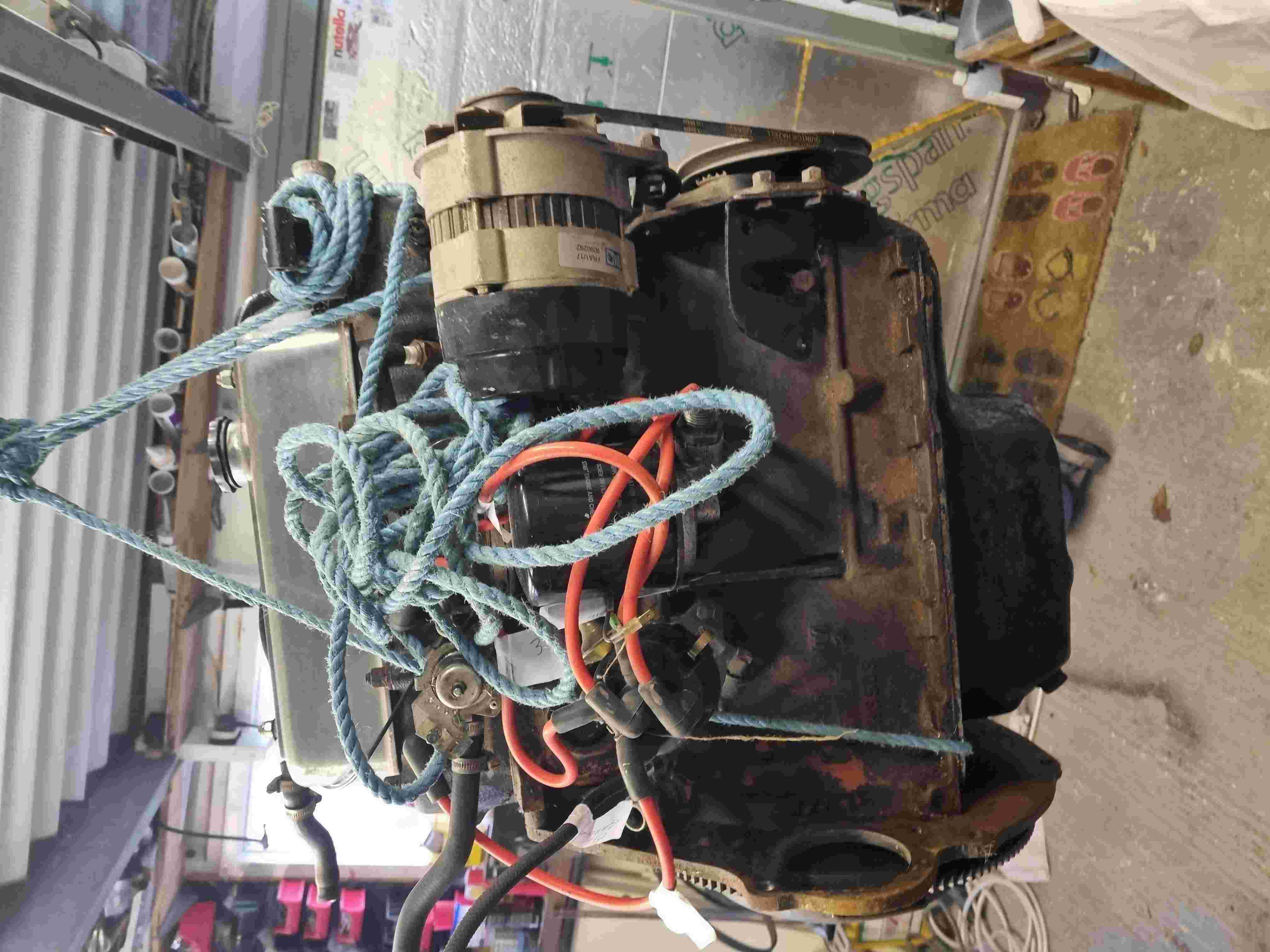

Im removing the B series engine now as it sold immediately on Ebay. Not sure whether to remove it on it's own or with the gearbox.

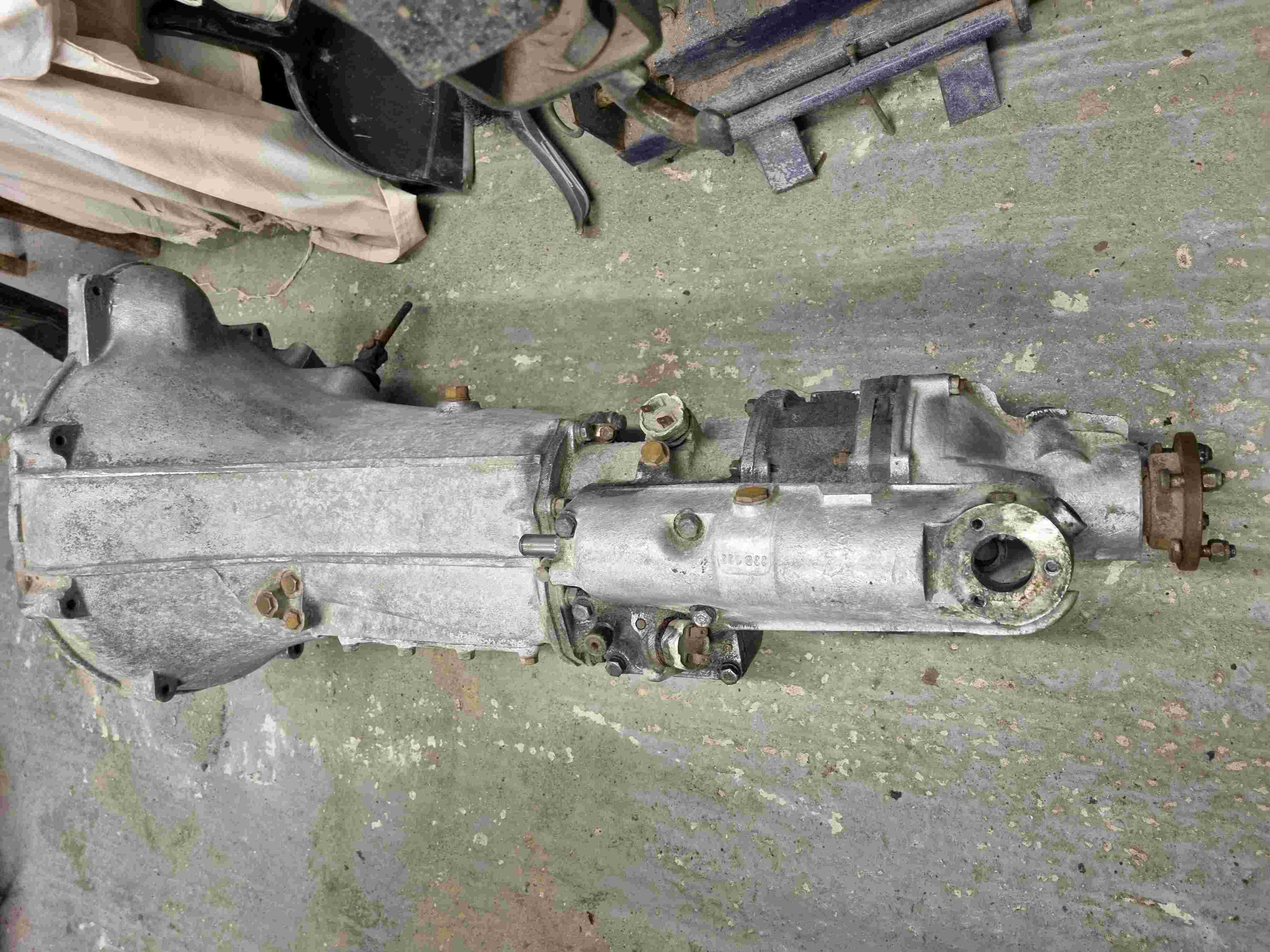

I'll be selling the gearbox separately at some point so for now I’m just trying to decide if its going to be easier to remove the bellhousing bolts and hoik the engine or if it would be quicker to separate the propshaft, undo the gearbox cross member and pull both out.

BTW my B series engine sold the other day for its buy it now price of £ 450 on Ebay. The starter motor has gone the same way for £ 45.
I'm currently waiting for bids on the overdrive gearbox but im confident that together they will cover my cost on the 67,000 mile MX5 donor.
