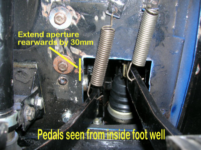

Have you tried to put the whole assembly in the car yet? On my 1969 GT I had to open up the aperture to get the pedals to go through the hole.

Like you I had to open up the hole for the pedals and added a couple of rivnuts where needed, other than that it was straightforward. I got some useful advice from the other MG Forum that we both visit regarding the dismantling of the servo. I was surprised to find the diaphragm to be soft and supple, really looking like new but it was covered with a gel of some description. The only part that definitely needs replacing is the seal around the pushrod from the pedal, but as yet I haven't succeeded in removing the valve on the pedal pushrod
