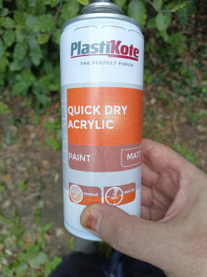

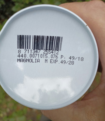

I found some aerosol, Plastikote matt magnolia just under £6, spray on a paint tray and touch up with a very very small brush, good results..
