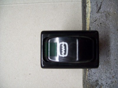

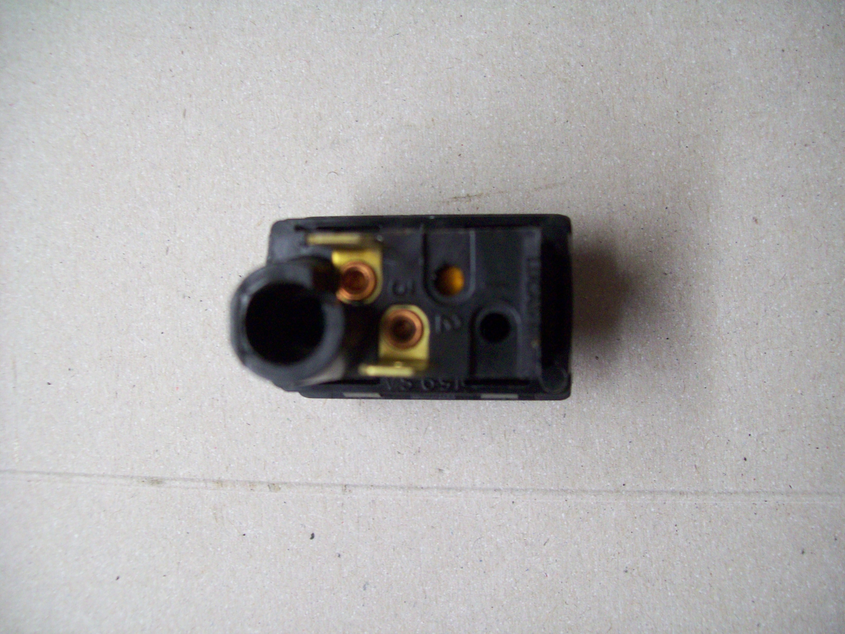

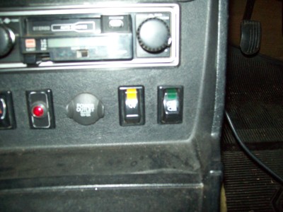

Just for interest I fitted two Lucas fog lights underneath the the chrome bumper of my 1974 Roadster. I have been lucky in sourcing two 159SA rocker switches with illumination: 30429A Green Heated Rear Window and 34196B Amber Fog Light. I re-purposed the green switch for my Lucas LR14 spot lights and stuck on a suitable symbol. What I have not been able to identify or source is the correct bulb to fit the switches; however I managed to make holders for LEDs from bits of small plastic tubing, although they might be a bit too bright.
I note there is currently a Lucas illuminated fog light switch for sale on ebay. It is listed as a 33797 but is rather tatty. Be aware there are larger Lucas rocker switches available (coaches, trucks, etc).
All the best, Barry
