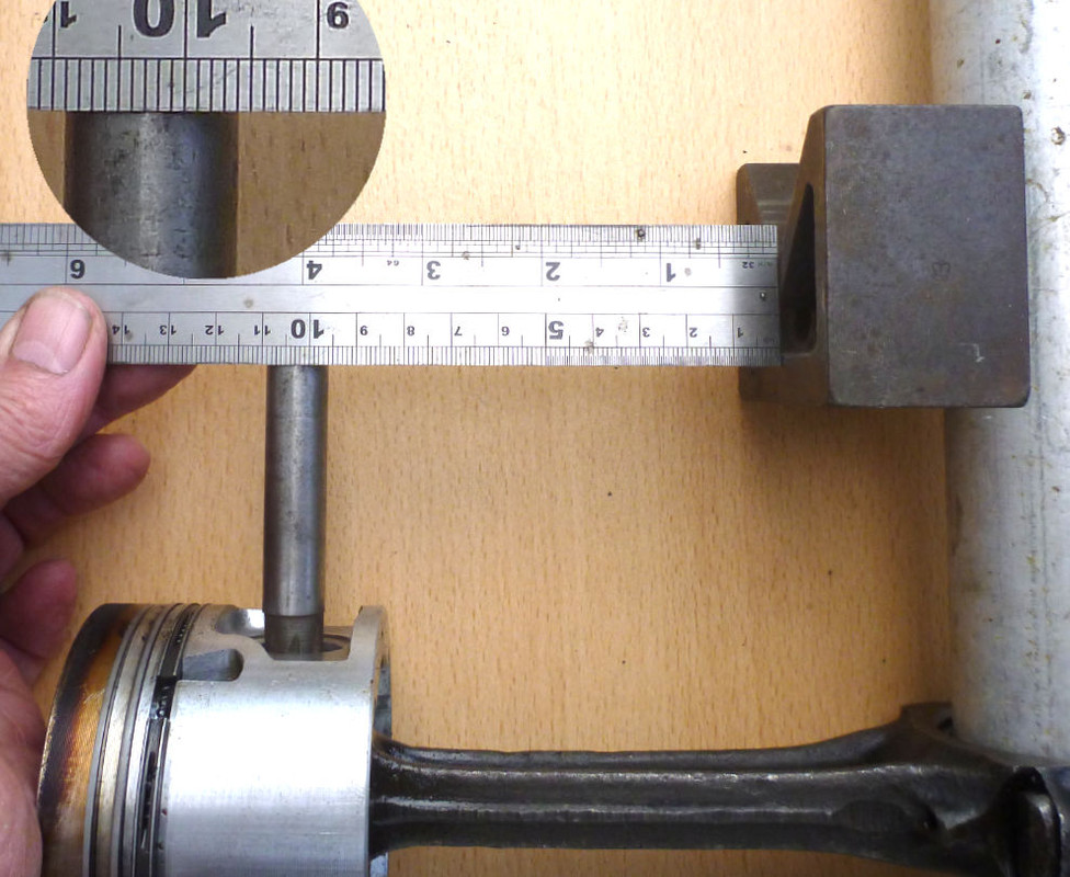

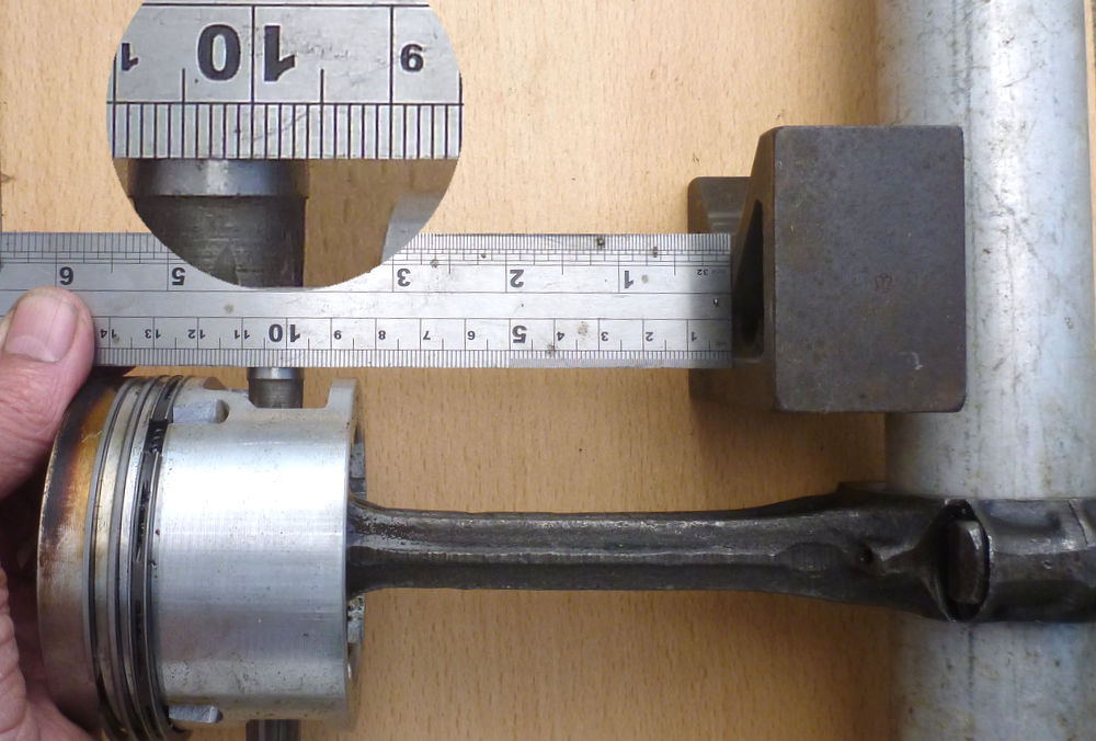

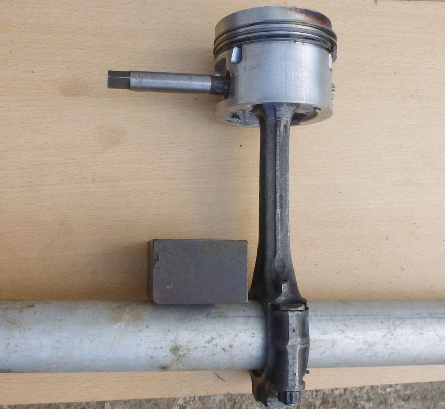

I clamped the rod to an alloy tube and using a reamer with a snug fit in the gudgeon pin I measured at each side to see if there was a slight bend in the rod (this is the cylinder in which a valve and piston have been replaced).
At each side ( I reversed the reamer) there was no discernible difference in the measure.

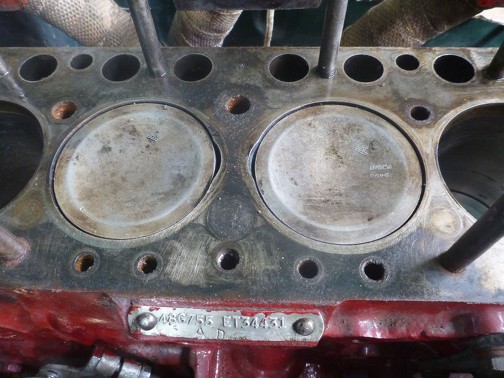

I notice that this piston has burn marks above the compression ring at one side (directly above the pin) and hardly at the other. The new piston was fitted in 2016 and has not done 1000 miles since (according to MOT records). This makes me think the piston is tending to be at one side of the cylinder during combustion, which is why I wondered if there was a bend in the rod. The piston could be moving to one end of the pin by default.
The piston moves very freely on the gudgeon pin, but not enough to have excessive play. I will pull another piston and rod (original) and compare.

I've taken the other pistons out and have done a little video to show what I think may be the answer. Or not. https://youtu.be/hYu_98XYFKc
The newer piston is looser on the gudgeon pin than the originals. It seems to slide along the pin more easily and may be making the knocking noise as it does so. The noise seemed to come from the front of the engine and was more audible from below the car. (Less tappet thrash confusing the issue).

There should be quite a bit of sideways movement of the pin in the piston, but what you should have zero of is a vertical slop - I think that's what would cause little end knock?

All are standard and the bores have no ridge. Just looking at the pics I realise the valve cut-outs in the block are the reason the pistons have burn marks above the compression rings. That may be why the piston moves along its pin. the explosive force pushing on that side of the piston.
Again, having just been started and never run properly, there is a lot of carbon in there from running on choke and never getting up to temp.
Similarly, it looks like the head gasket was never nipped down after a few heat cycles.
