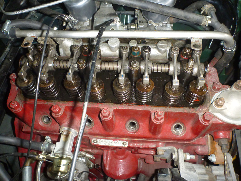

The rocker shaft is like new, pads not worn and shaft unmarked. The bushes in the rockers are unworn. As I understand it the shims (which are present) fit under pillar 2 & 3.
The head is removed (see pics of the pistons). As the tapping seems to be half engine speed (I used a timing light to assess this) that would agree with the one piston moving along the pin on just ignition strokes. Pulling the HT lead when running was a bit inconclusive, but it did seem quieter.

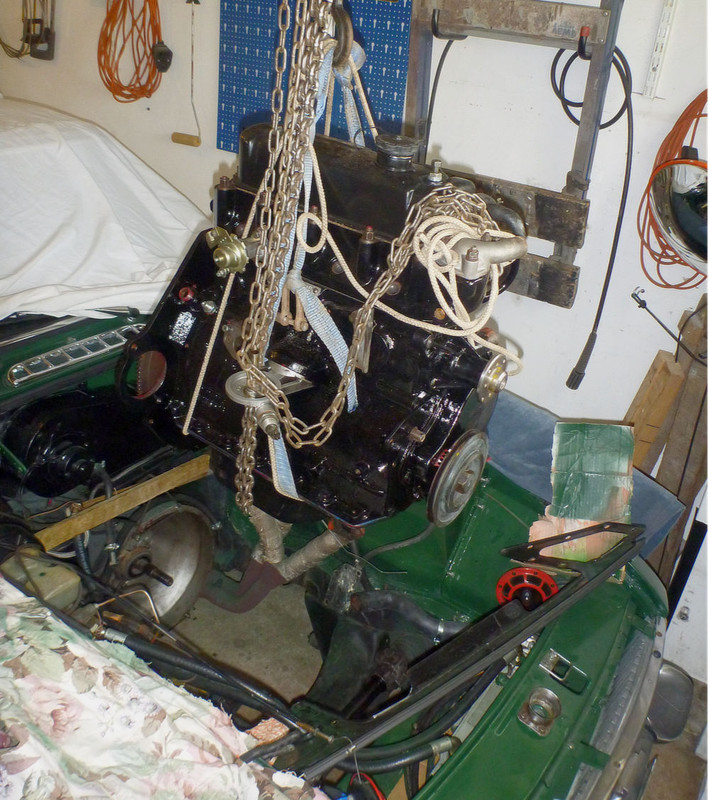

So it was a little end rattle. Which is what I initially thought I'm still fitting a new cam and followers (when they get around to grinding it), and big end shells. (The mains are fine). I checked the almost-new oil pump, which is unmarked, but am leaving the cam bearings, as they are OK except for a little scoring on the front one, which isn't as bad as it looks in the pic. I've painted the engine black. I did try red, but it was too orange and a bit gaudy. I also did a lot of cleaning and painting in the empty engine bay, as it's easier than struggling with the motor back in.

With buckets full of cam lube and assembly lube I put it all together and spent the last 2 days sticking it back in the car.
