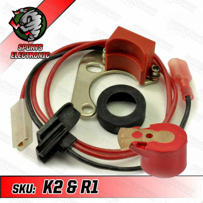

I have a Powerspark £35 module.
Easy to fit, adjust timing and away you go.
2yrs so far, never missed a beat.
https://simonbbc.com/Powerspark-Electro ... tor-K2--R1
