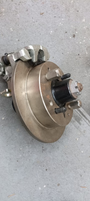

I upgraded my brakes, not because they were poor, they are not, they are perfectly OK, but I was finding that other drivers on the road had their brakes on all the way down hills causing me to use mine more then normal, so the 'upgrade ' was just to keep up with 21st century traffic.
I looked for some time and could not find a suitable direct replacement, so I ended up getting the Frontline conversion, fits the wheels , vented discs.
I did the rear conversion to discs too, turned some discs myself from a Rover 800, and had to get correct size caliper, so as not to over brake the rear axle.
It's not a simple job, as the brakes don't improve the stopping distance, just fade mostly.

Rear disk are Rover 800, turned down a bit, Rover 400 diesel rear calipers and the Rover handbrake cable. All fits nicely, needed a mounting bracket, but that was a simple part cut from 10mm plate to get the fitting angle correct for the handbrake cable.
