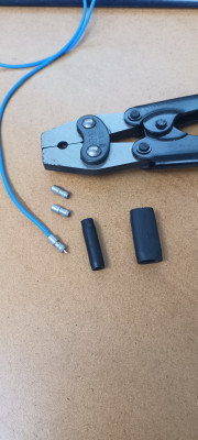

For the benefit of anyone who isnt aware or hasn't yet had to work it out the hard way like i just have:
Lucas bullet connectors need to be fitted using a dedicated crimping tool (or just soldered very carefully at the end).
Regular crimping tools and crimping ratchet pliers intended for generic electrical spade, ring and bullet connectors are utterly useless for Lucas bullets. However carefully you will try they will confound your efforts by squashing the Lucas bullets so they no longer fit in the sleeve connectors and also the wire will pull straight out as soon as any mild force is applied. Doubly useless and dangerous.
So, never confuse the words Lucas and lucar when buying a crimping tool intended for the Lucas bullet connectors on your B. Otherwise you will end up with something as much use as an udder on a bull.

Ive soldered the ones that I have added and replaced but with the intention of also going back and crimping them when the tool arrives.
And as I was typing this I just heard a resounding thud on the doormat so hopefully the right tool has arrived and I can progress this over the next few evenings.
Please shout if anyone wants to borrow it.

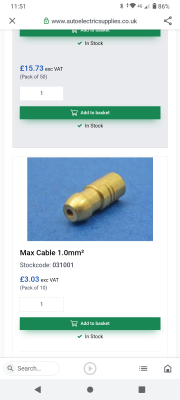

These are the bullet connectors I use. Very solid and very easy to insert the wire and solder in place. Available in different sizes to suit all auto wires.
