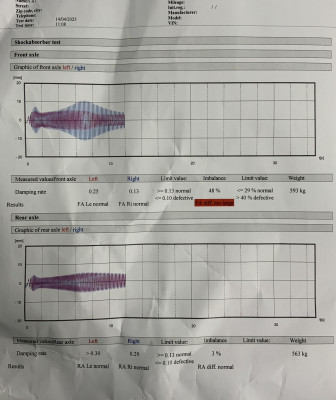

The car originally failed on the offside / Right front shock absorbers. I ordered two renovated replacements from one of the well known / respected MG parts retailers and had a local garage install them. The Shock Absorbers are standard MGB lever shocks. At this mornings follow up test, the front offside failed again with the compliance note saying the absorber needs replacement.
Before I have the new Shock Absorber removed and replaced, are thee any other actions I can take to try and remedy the problem?
I admit I do remember when the replacement absorbers arrived that one seemed less stiff than the other when the package arrived. The package also had a dark stain. I checked for oil leaks at the time and didn’t find anything , so assumed the mark occurred whilst the package was freighted over. Is it possible that the shock absorber simply needs an oil top up?
In case of use, I’ve added the print out of the test results showing a 48pc imbalance.

That's quite a technical test!
If these were reconditioned items then one may be faulty.
Otherwise, check and top up oil, and then make sure you have removed any air in the valving by working the shock absorber arms up and down over full strokes. Has to be disconnected from the upright of course to do this. Air in the valve and lack of oil could give the symptom you describe.

So the oil level in the refurbished Armstrong was good. My efforts to get it to stiffen have had no discernible effect.
My instinct is to take the expense on the chin and just buy two new shock absorbers. It’s overkill, but it seems the likely way to obtain a pair that are close enough in performance to get past the dreaded Jersey DVS test machines. I’ll keep the refurbished ones as spares.
