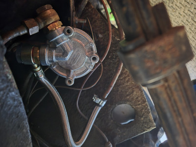

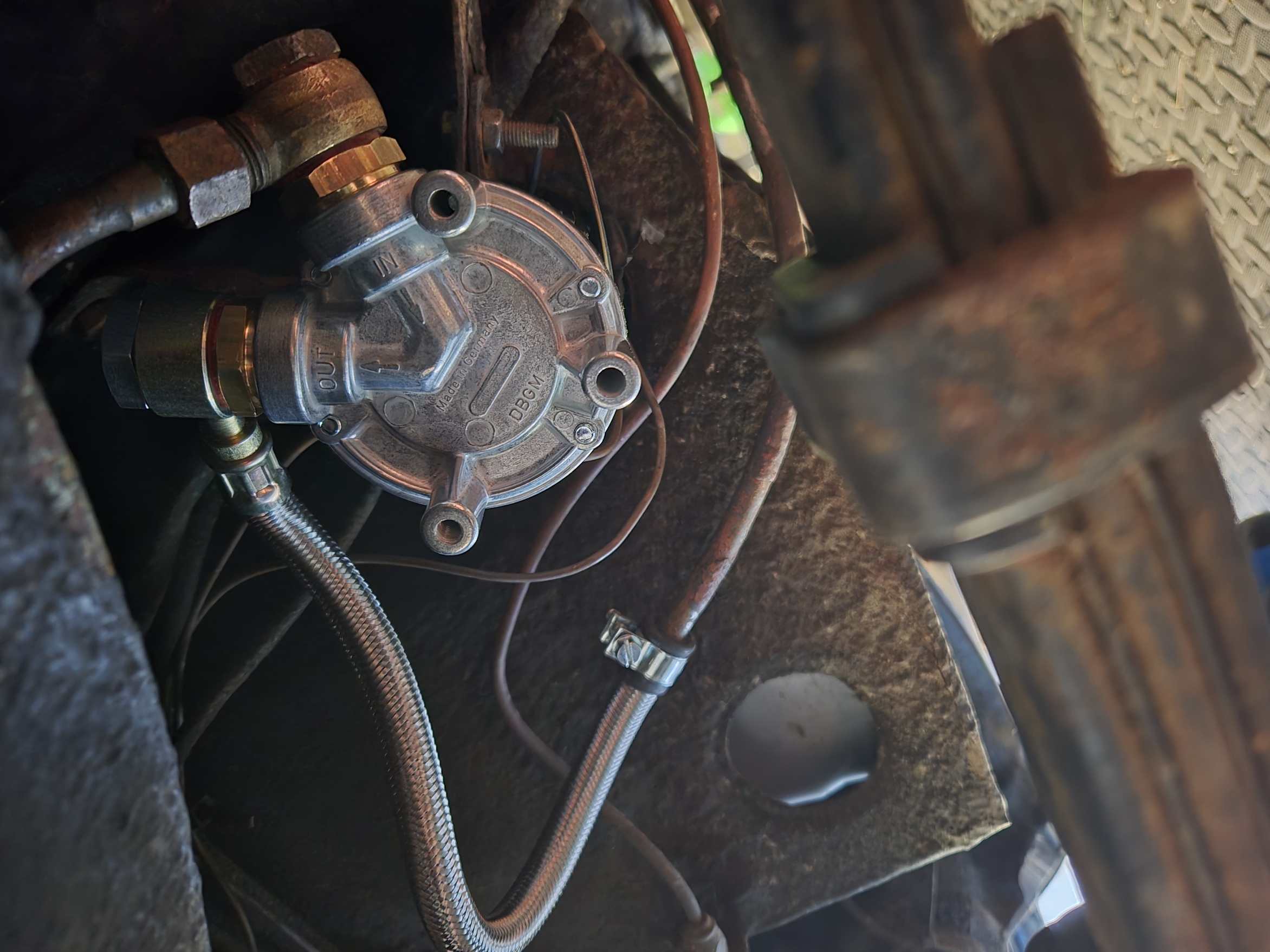

Hi,
This is how it is set up. The outlet is at the top but at a slight angle.
I am pretty sure that the petrol goes through the pump as there seem to be a slight leak from the outlet banjo. This might be part of the reason that the car doesn't start. As for the continuous hum, I don't know if it should be heard all the time or if it should stop at some point. I'll need to check that the fuel goes to the carb and change the seal on the banjo.

The Hardi I had clicked just like an SU pump, and stopped when the carbs were full. It didn't hum. Your outlet faces up so should be OK. Have you measured how much fuel is reaching the carbs? Disconnect the feed pipe to the rear carb, put it in a container and switch on the key. It should deliver at least 1 pint in a minute in a continuous stream of pulses, with minimal bubbling.

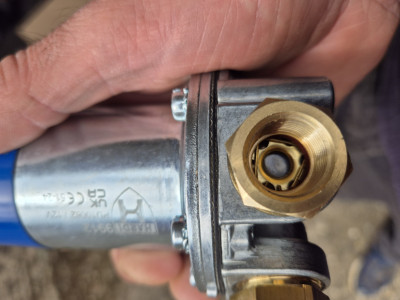

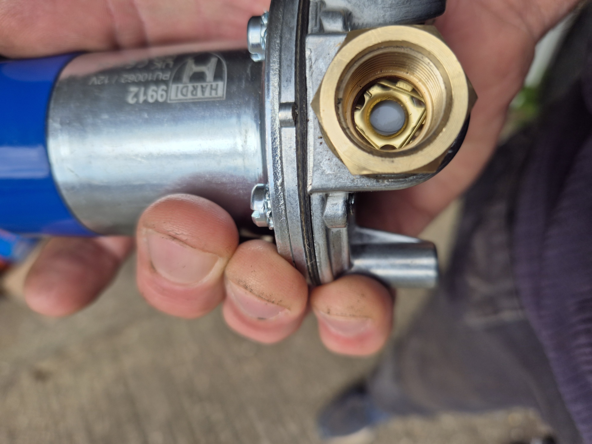

Another thing that is bugging me is that there's seem to be what looks like a white plastic cover inside the inlet and outlet. Is this part of the diaphragm?
See picture below

Those spherical (?) white things could be non-return valves?
