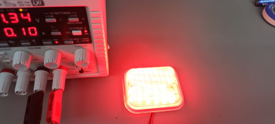

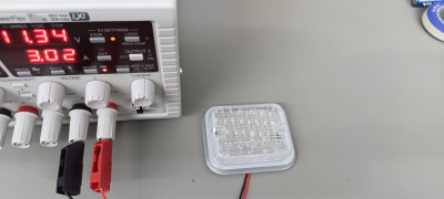

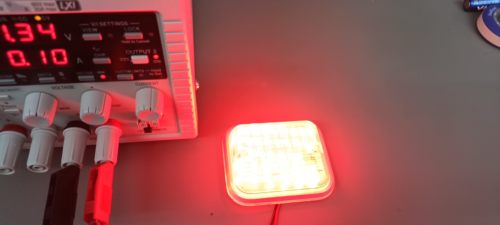

I was looking to add a fog light to the BGT, decided to modify one of the two reversing lights, I now have one white reversing light and one red fog light...

That looks really neat. Are you adding a visible or hidden dash switch for the lamp ?
Re: Fog light
I got a Lucas fog light switch (Morris Marina HL) it's an identical fit in the centre console, it does need a mimic indicator, so you don't accidently leave it switched on...
Re: Fog light
I hope you have mounted the fog light on the offside of the car (driver's side). I think that's a requirement.
Re: Fog light
The fog is on the RH the reverse is on the LH
