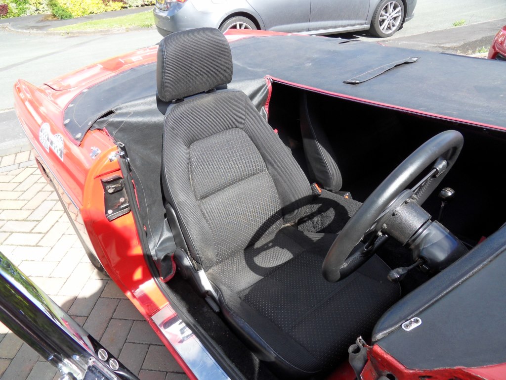

I recognise those problems well. I'm same age and have same problems with knees and ankle, and a few other joints! One thing I have done is to replace the original seats with more modern and stronger seats (from an MX5) so the effort I can exert on the brake pedal is wholly transferred. I have found this to be quite an effective alternative, and on even long trips (we went to the south of France last Summer) I have not experienced a flare up of arthritis. The original seats are well wrapped up and safely stored. The headrests are easily removed (much more so than the later MGB seats with headrests, so you get a nice flat tonneau cover.
See this thread: viewtopic.php?f=3&t=100&hilit=mx5#p532
Unfortunately something seems to have happened to the picture on page 2 so here is another couple of pics, which were taken during a front wing replacement hence no windscreen.
[attachment=0]Seat 2.JPG[/attachment]
[attachment=1]Seat 1.JPG[/attachment]

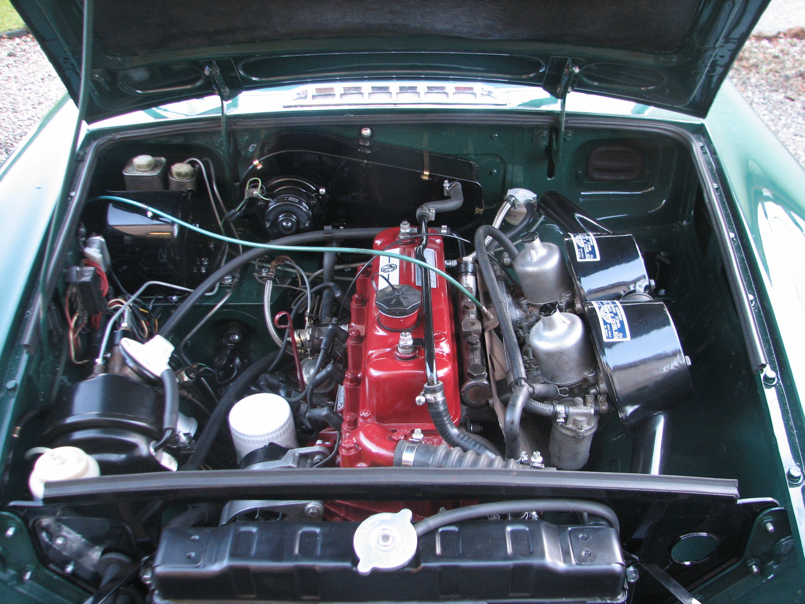

With reference to servo position, for the best and shortest pipe run, I always fit them to the R/H inner wing, in this position it does not get in the way of any service actions, or engine removal

Hi Pete. If l may barge in on Mike’s topic , regarding the photo you submitted showing the alternative seats you use , l noticed you have fitted a non-standard steering wheel. I have just had power steering fitted to my BGT and wondered about changing the standard wheel for something smaller. I tried a 13inch semi-dished one and thought it too small. I was curious to know what size you have fitted , l see it is also a flat wheel , and your thoughts on its use.
Any advice from other forumists would be welcome. Ray..

It is a Motalita wheel, and I think it is 15in diameter against the 16.5in diameter for the original wheel. A 14in wheel is about as small as you would want to go but that will mask some of the instruments including the important oil pressure/water temp gauge. This means you have to look around the rim of the wheel to check these. I don't have power steering and the effort on the wheel is only really noticeable at parking speeds despite having the adjustments to the suspension geometry outlined below. A flat wheel gives the driver the same comfortable driving position as the car originally had, but this is personal. Motorlita do spacers so the position can be adjusted with a flat wheel.
For others reading this - the most important areas for light steering are the alignment of the top and bottom parts of the steering column at the U/J and the top bearing in the kingpin assembly. An out of alignment column puts loads on the universal joint which makes it stiff and the top bearing in the king pin assembly can be changed for a needle roller bearing. Do these and the steering will be almost as light as with the power steering kits, and will retain the feel of the original set up. Other influences are the caster angle of 7 deg which is too high as standard for modern radial tyres, and the camber angle of 1 deg positive on the front wheels. Caster reduction kits are available (but you have to realign the two parts of the steering column) and the camber can be made slightly negative (to 1 deg negative) by using off set lower bushes in the king pins which is a bit fiddly as they have to be taken apart to measure this or by using the longer bottom arms which give around 2.5 deg negative camber but still need the off set bushes so it can be adjusted to be the same on both sides. The setup on my car is 4 deg caster angle using the B&G kit, and 1 deg neg camber using offset bushes and 8.5in free length 600lb/in front springs, plus 3/4 in antiroll bar with polybushes.
