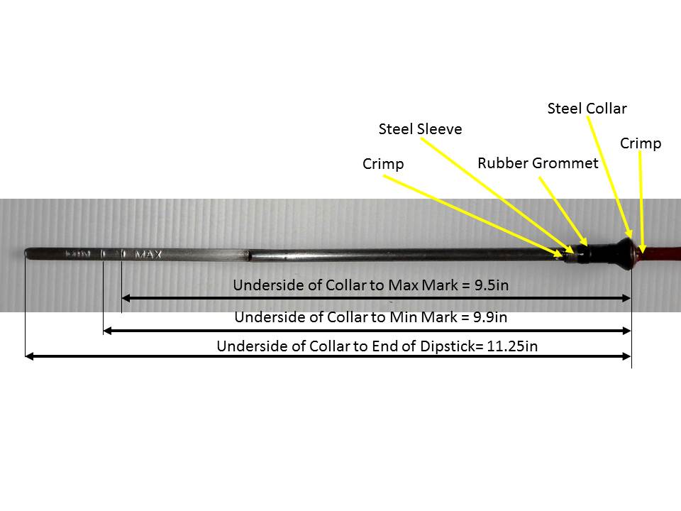

Re: engine oil dipstick
Having changed the oil in my Roadster recently, I took the opportunity to take some pictures and measurements of the dipstick, which I hope will help the discussion here. The car is a 1969 Mk2 with 18GG engine, which although not the original engine it was a like for like replacement supplied by Mechspec.
The collar on the dipstick is permanently fixed to the split shaft by a crimp above the collar and a second crimp below the steel sleeve. The grommet stops oil splashing out or the dipstick tube, the end of which is flared so the grommet seals completely when the dipstick is pushed fully home. All the parts and relevant dimensions of the dipstick are shown in the picture. The dipstick doesn't touch the bottom of the sump.
[attachment=0]Dipstick.jpg[/attachment]
- Dipstick.jpg (42.95 KiB) Viewed 24471 times
