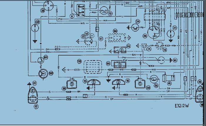

I had a look at the wiring diagrams for both 1970-1971 and 71-72 year cars and can see courtesy light /map light (item 101/102 on the radio console is operated by the front door switch items 21 and 22. The luggage compartment lamp is operate by a separate switch operated by the tailgate .Theses are items 65 and 66 respectively on the drawing . If it helps the wiring colour is PW (purple and white) for both circuits. attached part of the Schematic showing the interior lights. Sorry about the quality, but hope it helps
Mike Barclay
Mike Barclay

According to my schematics the change to the way the switches /lights work was made from Chassis no GHD5 219002. (GT Cars)
Hope this helps.
Mike Barclay
Hope this helps.
Mike Barclay
