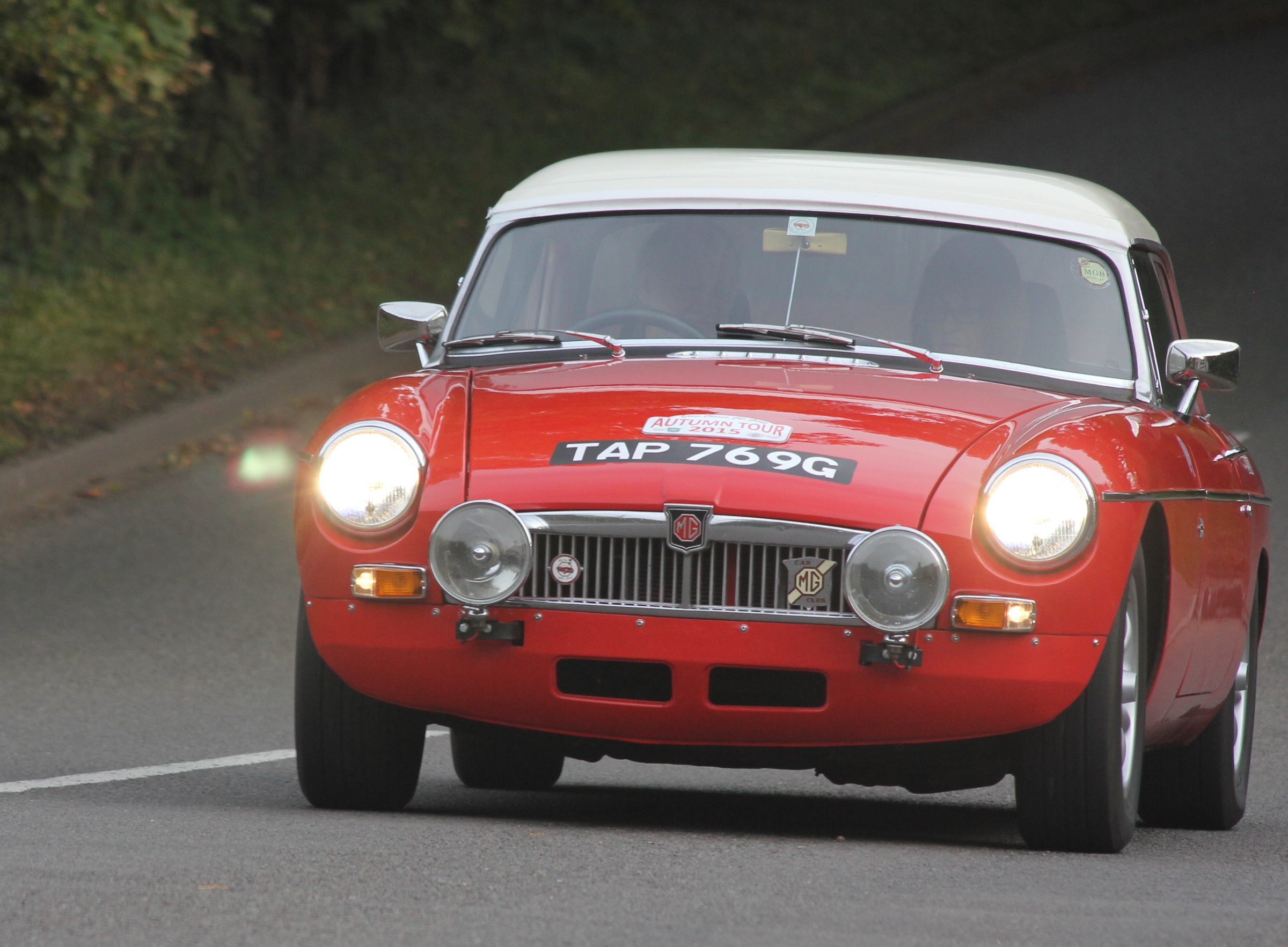

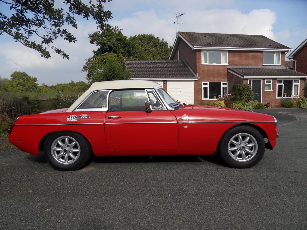

In Clausager's book 'Original MGB with MGC and MGBGTV8', all rubber bumper cars used the MGBGTV8 front crossmember plus longer front springs to achieve the higher ride height of 1.5in. The crossmember has 0.5in steel pads attached at the mounting point to the chassis, so the spring gave a 1in increase in ride height. So just changing the crossmember from the RB one to a CB one will lower the car by 0.5in, but then you get into the realms of which spring. The obvious choice is the CB roadster springs. You then have consider the rear springs, and again the obvious choice is the CB springs. This is where you will hit a snag as the car will almost inevitably ride tail high. You will be told they will settle quickly - they won't! So then what do you do?
This is where the conversion kit comes in. You don't have to change the crossmember and the front and rear spring are (or should be) compatible. I would suggest you buy from one of the quality suppliers. You might pay a few quid more but they have a reputation to maintain.
Roll centres are a very complex subject, but unless you are prepared (and able) to re-engineer the front suspension you are stuck with what MG gave you! The rear is simple - the roll centre is in the centre of the diff housing and you can't change that without changing to an independent rear suspension set up. at the front as you lower the car the angle of the front arms changes from pointing down from the pivot point on the crossmember to the bottom of the king pin to pointing up from the pivot to the bottom of the kingpin. I can though confirm that this doesn't necessarily produce an evil handling car, as my car is lowered 2in at the front and 1in at the rear, and now has a level stance (the chrome line is parallel to the road), but I gone much further than this as the front spring are 8.5in free length and 600lb/in rate, it has 1 degree negative camber and 4deg caster (compare to 1deg positive camber and 7deg caster) and a 3/4in anti roll bar.
The effect of all this can be seen in the pictures below. I do need to beware of sleeping policemen and going on and off ferries - but it has got a ver strong exhaust system!
[attachment=1]385v2.JPG[/attachment]
[attachment=0]SDC11798v2.JPG[/attachment]

Re: Suspension springs
I don't know why the first picture disappeared, so here it is again:
