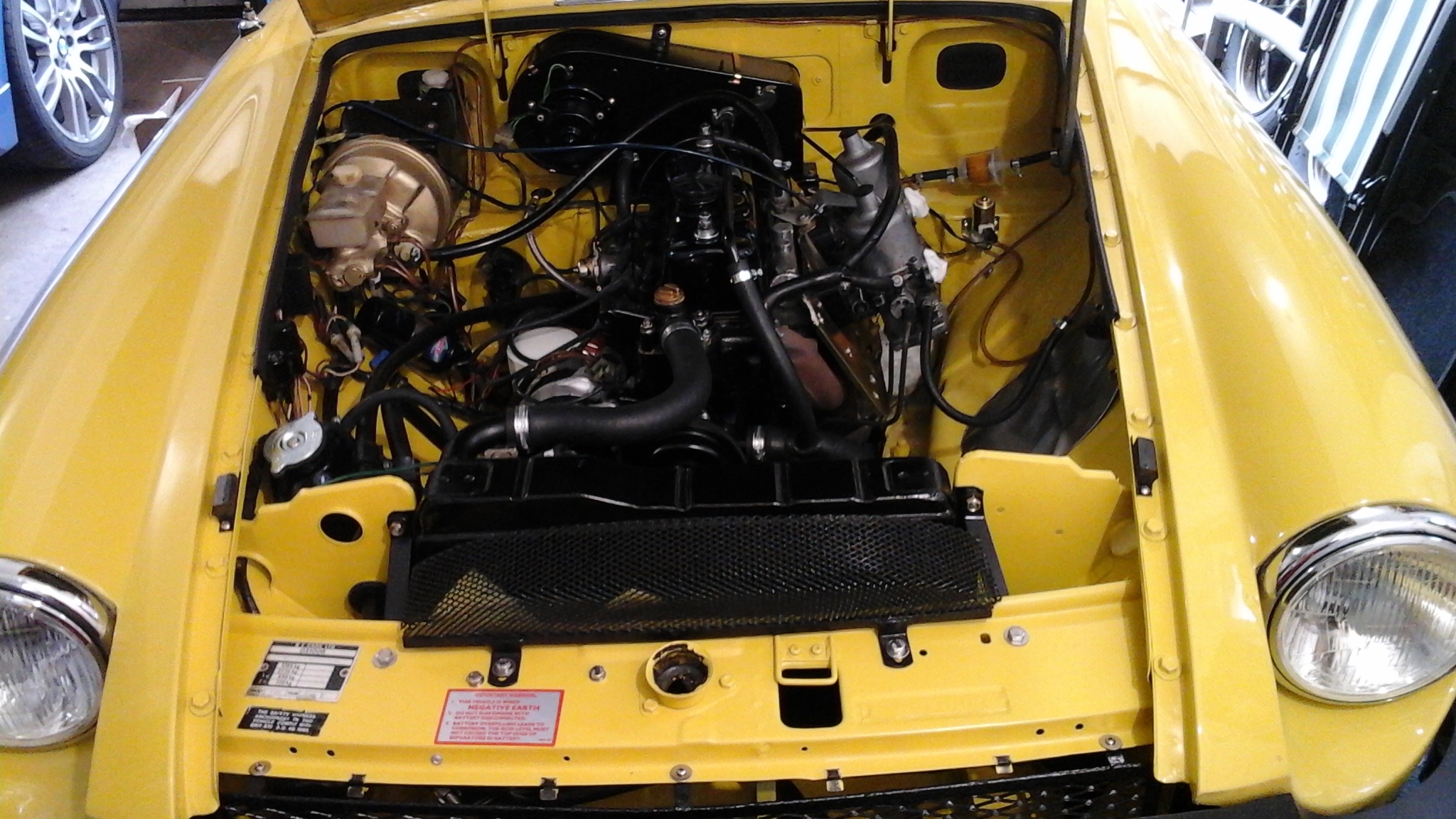

Re: Fuel pipe layout
Hi,
My car has HIF carbs. The fuel line crosses across the back of the engine block & through the fuel filter & then comes down the side of the inner wing & then connects to the front carb. (See my attached photo taken during my recent refurbishment when the air filters hadn't been put back on.
Cheers, Charles [attachment=0]20180413_155137.jpg[/attachment]
