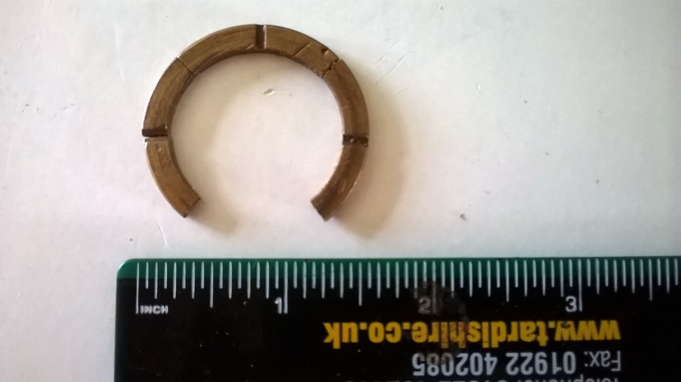

All was well until I dropped the gauze filter. Sitting on top were parts of a thrust bearing.
See picture

I have checked the microfiche and looked at the only part that it could be and it looks totally different.
Has any one got any thoughts?

Although you don't give the year of your car or the type of overdrive you have, from the fact you ordered a gauze filter I assume the Overdrive unit is the LH type with the internal solenoid rather than the D type with the external solenoid. However looking at the workshop manual pictures, both types have a thrust washer associated with the unidirectional clutch that looks like the one in you photo. This raises several questions:
1. Where is the remaining piece of the thrust washer. You don't say if the O/D unit stopped working during your ownership or if it was not working when you bought the car. It might be that a previous owner found the missing piece and the big bit you have found was lurking away somewhere inside the casing.
2. I am guessing here but I think it is possible that the solenoid failed and it stuck in overdrive. Since the thrust washer is associated with the unidirectional clutch if an attempt was made to reverse the car it might have shattered the thrust washer at that point, and you have now found some of the debris that ensued. This is obviously a key part that limits movement of the unidirectional clutch.
3. You now have the problem - 'was the thrust washer replaced?', and how can you be sure? The answer is you can't be sure unless you dismantle the O/D unit, which isn't easy as a number of special tools are needed so it is usually considered a job for experts, and you have to remove the engine and gearbox/OD unit from the car to remove the O/D unit from the back of the gearbox. So all in all not a simple job of a few minutes!!
4. Continuing to use the car might result in irreparable damage being done, but the fact that operates without any odd noises might be a good sign but you will always have the worry that it might break at any moment.

If the car is reversed with the overdrive engaged, the uni directional clutch will be destroyed and the overdrive will spin round in its housing.
As you said it still works then that hasn't happened.
