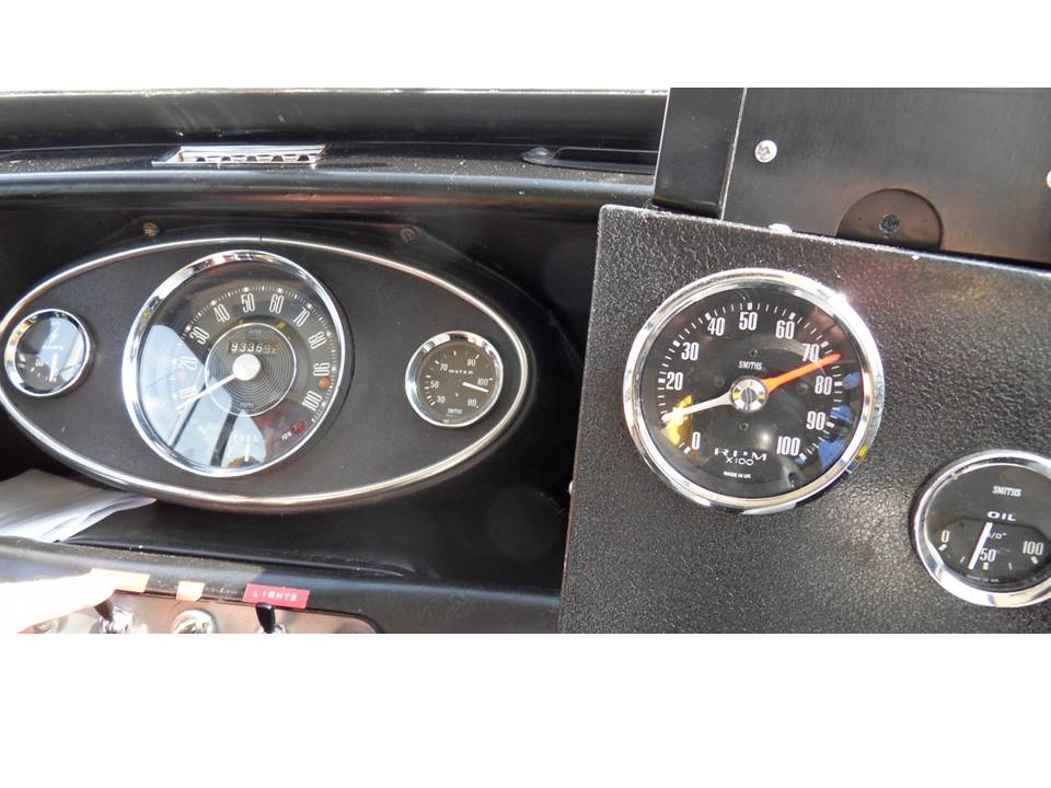

For reassurance he's a picture taken inside the Cooper when the ambient temperature was over 40 deg C and the water temperature was 105deg C. It was still idling at its normal 1000 rpm. This was on the way to the Le Mans Classic in 2010.[attachment=0]Stuck in traffic at Arnage. Water temp 105, but still ticking over at 1000rpm.
jpg[/attachment]
jpg[/attachment]
- Stuck in traffic at Arnage. Water temp 105, but still ticking over at 1000rpm..jpg (79.83 KiB) Viewed 21239 times
