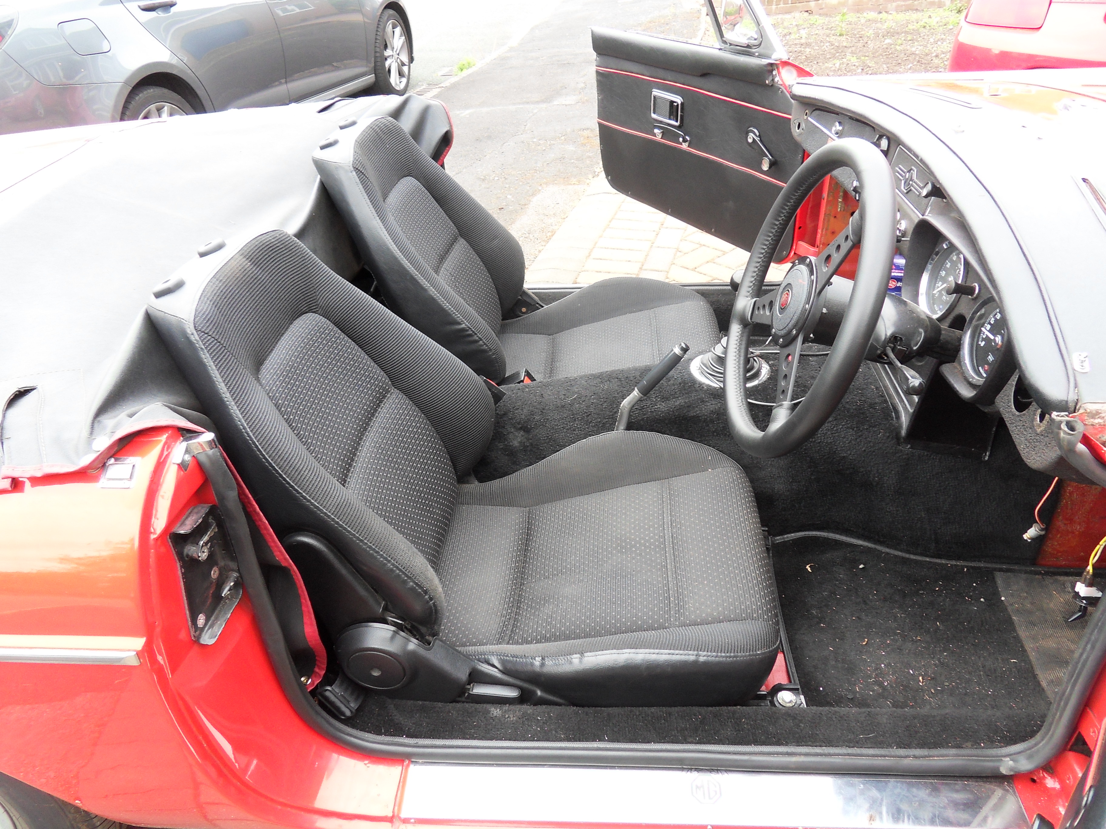

At last I dropped on a pair of MX5 black cloth seats on ebay and secured them at just over £81. They have come out of a late Mk1 car that had covered 50,000 miles, so they are in excellent condition. These are now fitted:
[attachment=0]SDC12927.JPG[/attachment]
The drivers seat was slightly harder to fit than the passenger side, because I wanted more for/aft movement than I've allow the passenger. To facilitate this I fitted the seats to pieces of strip steel and then bolted this to the floor. On the passenger side I managed to use the existing mountings. When the headrests are removed (an easy job as they remove like most modern cars do by pushing in a little button to release them) the tonneau cover fits flat on the car so the mod is not obvious when parked. I haven't driven the car yet as the drivers side front wing is off the car and so it doesn't have a windscreen yet, but they feel quite firm unlike the very saggy seats I had. If I find I sit too high in the car I might try cutting some of the base foam out to get my bum closer to the floor!
