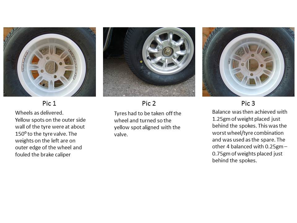

I've just had a look at my own car (which is easy when the front wing is removed!) and the track rod end is indeed very close to the inner wheel rim. However the weights are placed further into the well of the wheel and so miss the track rod end. I got my wheels from B&G but any wheel fitter/balancer should be able to get a perfect balance with only a small amount of weight place behind the spokes. My wheels are Minator, other makes might throw up different problems.
It is very important when the tyre has a spot on the outer side wall, that this is aligned next to the tyre valve. When this is done you should get a balance with less than 1gm of weight placed about half way into the well of the wheel. Although these pictures were of my Mini Cooper, they do starkly make the point that it is important to line the tyres up correct. The tyre fitter saves his company a load of money as well as he uses less lead!
[attachment=0]Wheel Balance.jpg[/attachment]
Incidentally the wheels were genuine Minilite and they reckoned the wheels alone should balance with no more than 0.25gm, and the tyres were Yokohama A008 and they told me the tyre was manufactured to balance with less than 0.25gm!
Be fussy and ensure the spot is next to the valve!
