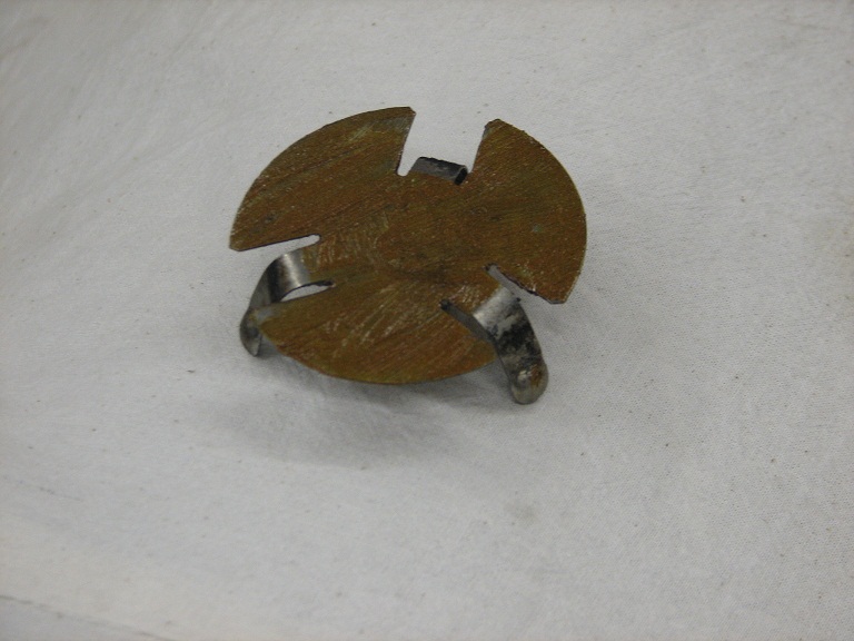

Like a lot MGB owners I also suffered from severe brake squeal, after trying a number of methods to try to stop this, including different makes of pads, different makes of discs, I finally managed to cure it by fitting some anti squeal shims from a Peugeot 806/Expert, since I fitted these I have had no problem with noise, as soon as I had fitted these shims we took the car to Switzerland and Austria and spent 3 weeks driving in the mountains, and had no brake squeal what so ever, and that was a few years ago, and many thousands of miles, and to this day still no brake squeal.
- 002a.jpg (121.06 KiB) Viewed 34576 times
Dave Linkson
- Posts: 83
- Joined: Thu Nov 06, 2014 9:08 am
- Forename: Dave
- Surname: Linkson
Re: EBC Brake pads - Dust and Squeal
Andrew, that's interesting to know..
I have at the moment shims that are cut from thin sheet aluminium which my good neighbour AA patrolman recommended as they cured the squeal on his daughters BGT, but it hasn't eradicated the noise fully on mine but remains an improvement over the noise it was and can now live with it, anyway, the wife wears earplugs (phones) but think it's not to hear me cussing either..
