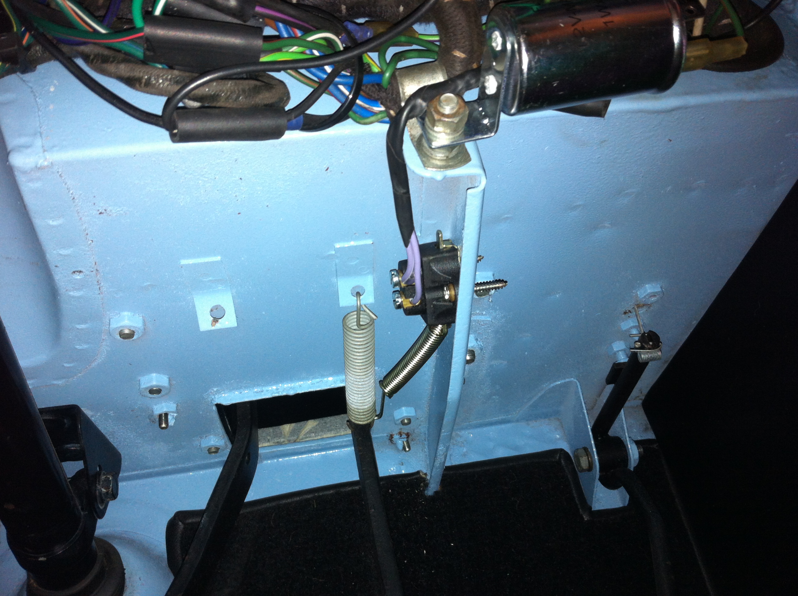

Could post some photos of the switch fitted, my hydrualically operarted one is on the way out.

John Here is a picture of mine the switch was bought of eBay.
Nothing has changed under the bonnet so it still looks original, hope this helps.

You must fit he clutch pedal return spring - missing in brake switch photo.

Thanks for the information.
Re: MGB Brake switches
Now fitted George
