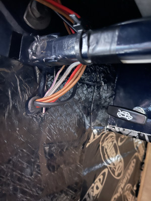

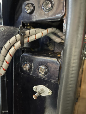

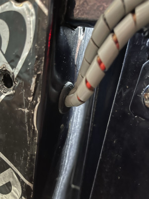

Re: Central locking
Remy
Pictures of my car cable run. Ignore the volume of wires you see as my car has electric windows. The grey spiral wrap is my addition but the original speaker cables where just bare wires, I have also tie wrap the cables to the hinge which I think is better.
