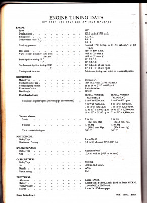

If your engine is an 18V582 then hopefully the attached might help. The 18V581/2/3 series engines were in production cars from 72 to 73. They were fitted with the sort- after big valve head. In late 73 (November time) the engines were changed to the 18V846/7 engine with the introduction of HIF carbs and the 45d distributor. The engines are all painted black.
I suspect the “spare “distributor (41288) that came with the car is the original one for your engine. They are prone to seizing up if not regularly lubricated. Check the shaft the rotor arm sits on moves and the bob weights are not seized on their pivot’s. Fitting one of the readily available electronic modules in place of the points will help compensate for any play in the distributor and eliminate dwell angle settings. The attached info gives the advance curve info for centrifugal and vacuum so you should be able to check the operation of the distributor using a strobe light. Your engine started life painted black. Hope this helps.
Best regards
Mike Barclay
Best regards
Mike Barclay
Re: Strobe timing at tickover or high revs
