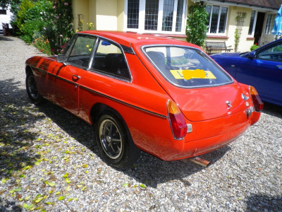

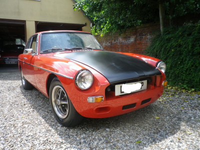

Well as there is a new section on here and I don't visit very often I thought I'd mention my car and this seems the place to put it (mods please move to MGB general if you feel it more appropriate).
I will start by declaring that it is not a competition car - YET. I've always been involved in motor sport and spent a good number of years in my 20's and 30's in the passenger seat of various modern and historic stage rally cars culminating in 2010 (gosh ten years ago) with a class win on Wales Rally GB as it was then. I still do the occasional rally - about one per year as an average to keep my hand in.
My MGB was originally a 21st birthday present, Dad owns a 1954 TF which he bought in the 60's and it shares the garage with a couple of other MGBs so it's kind of in the blood. The car I got on my birthday was sadly written off when stationary in traffic and was rather hurriedly replaced with this car I have now and owned since 2003. The pictures show it's current condition. It's a 76 rubber bumper car and I'm in the process of fitting Sebring valences, the pictures were taken over the last few weekends and include the large amount of fibreglass filler required to fill the gaps!
I've just bought a refurb gold seal engine which the seller claimed to have done only 1000 miles since being built and then stored with nothing more than assembly grease in it.
The engine which is in there was an MGB Hive Fast Road Engine fitted in about 1993. In 2003 when the piston rings finally gave up we threw some pistons, an oil pump and valve seals at it and 17 years later it's somehow still going. The current plan is to take my engine out, drop the Gold Seal in so I have a running car for 2021 then as money and time allows build a fast road/track engine from the old one. If it's really too far gone then I'll use the Gold Seal for the upgrade but I'd rather keep the car running.
Ultimately (and this is why it's in this forum) I'm thinking track days (MGs on Track) and sprints/hills would be a good place to have some fun without breaking the bank. I plan to fit some proper harnesses and towing straps front and rear. I'm toying with the idea of a rear section roll cage for added safety whilst still keeping it as a practical road car but I'll see how that one goes.
Ages ago Peter Cresswell gave me some good advice on the old forum and by e-mail and sort of got me started on this project but it was delayed by a house extension project and then Lockdown - the garage is 60 miles from my house which is not ideal, so thanks Peter. I'll be asking some more questions as I go.

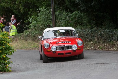

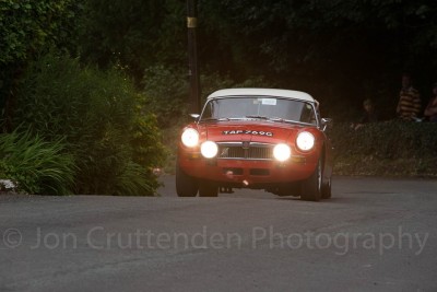

Here is a couple of pictures of my at at the Oakamoor Hillclimb Revival last year

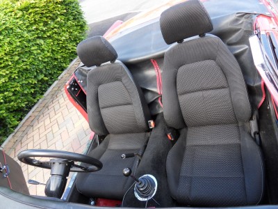

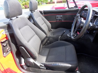

Seats - you can use the standard seats that your MGB came with, but they are not very supportive, and the single post headrest doesn't keep the shoulder straps of a harness in place. I have fitted MX5 seats (from a late Mk1 or Mk2) to my MGB. They are a straightforward fit although on the drivers side I had to mount the seat on some steel strip first. Fore and Aft movement is restricted a bit by the transmission tunnel but they are extremely comfortable and supportive. I paid £80 on ebay for a pair of cloth ones - leather are available too but are usually around £400 as MX5 people want these as well! The main problem is finding a pair that don't have a worn bolster on the drivers seat, but you can source covers from Germany where the cars are LHD! Pictures below:

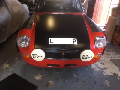

I've made some slow progress since my initial posts so I thought I'd put a few updated pictures here. The paintwork has been done by a professional painter, it still needs a new or repaired passenger door so that's on the list. I had a tinker with some spot lights bought on e-bay but no wiring has been done for them. For Christmas I acquired a second hand Brantz Tripmeter and matching Brantz clock so the next part of the project is to start getting some wires in!
I'm not sure it will do any competition this year but I'm thinking MGB60 might be something to aim for!

Hi Tom, It's good to see you are making progress and the car is looking a lot more business like these days.
I have found a few sources of competition parts so I'll compile a list and post it up. One that caught my eye was a reverse gear lock-out to prevent you from selecting reverse when hurriedly changing down from 3rd to 2nd. If you do Sprints and Hillclmbs this is a gear change you will do many times, and you can select reverse!!!
Although I have a stick on number plate on the bonnet of my car, I am not sure about the legality of yours! Before 1973 (when they changed to white and yellow backgrounds) the rules were mostly recommendations as to font, size of characters and position of the number plate etc. From 1973 onwards, the rules became much stricter and I think the number plate at the front had to be vertical, or as near vertical as possible. I know a lot of post 1973 cars have the plate on the bonnet (including E-Types), but I suggest you do a bit of research and come to your own conclusions. You could try looking up leaflet INF104
I'm planning to go to MGB 60 so hopefully we might meet up there.

Yes I'm aware the number plate is an issue and was before I had it done. That is my spare bonnet, an aluminium one I picked up in the deep distant past so decided to use it. I have the original steel one still as well in matching orange. The worst case solution is to put a couple of rivnuts into the valence and paint them orange. The original plastic plate can be screwed in for road use.
Looking at the pictures of the Per Ardua ad Infinitum rally last weekend there are a couple of MGB rally cars post 1973 with the same setup in use.
