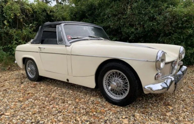

This one is £8750, and would be my choice if I didn't already have one!!

Ian, I think he is coming round to your way of thinking. A really good MGB is a bit above his budget, and as he has had a Midget before and liked it, he has started to look at them again. The one you show - where is it advertised?

Re: Is it OK to pass an MGB off as earlier than it is?
Hi Mike.
The Midget is currently on Mike Authers for sale list. He is at Abingdon and has a website.
He specialises in Midgets and usually has a small stock. I can only recommend him because that's where I got mine. He will look out for specific models, colours etc. if you ask.
