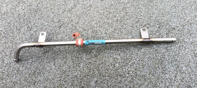

My understanding is that the 'kink' in the pipe is nothing to do with clearance or access, it is 'usual' to put 'kinks' in pipes that are subject to expansion and contraction with heat, it allows linear movement without putting stress on the fastening points, you will often see similar 'kinks' in heating systems and realy big kinks (like an omega shape) in steam pipes, I guess the original designer was a good engineer and put the 'kink' in as best practice.

Thanks Mike, that sounds to be the most plausible explanation we have so far. Since that pipe is fastened securely at both ends of the rocker cover I can see that expansion and contraction could cause some problems.

All a bit off topic but this is how discussions go....in saying that, I did make a new pipe from stainless steel, it has the same O/D but a thinner wall and looks better too.( the internal of the origlnal pipe was quite corroded, full of crud reducing the I/D and made of poor material) I didn't form a 'kink' in the pipe (I do understand expansion loops) but instead made the two fixing points able to flex so as not to stress the pipe fittings.

Nice stainless steel replacement pipe. If you fancied making another one I'd buy it.

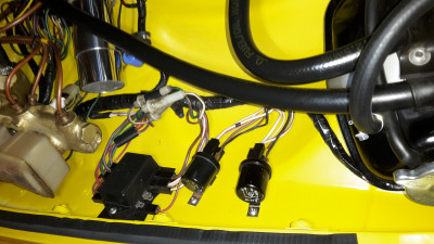

Apologies for photo being upside down - there is just about enough space to fit an OEM second fuse box below , albeit you would
have to deal with the "slant" of the inner wall & push the harness down & perhaps use the bottom box for the original fused circuits.
You could always move the relays forward & place the second OEM style fuse box there.
(Neither solutions are attractive to me)!
