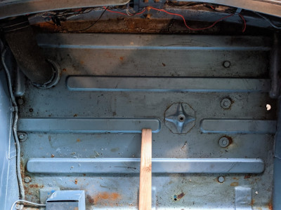

So I'm about to embark on this same project for my '78 GT. I've noticed now that at some point the rear part of the boot has been reinforced, I presume after some body repair work. The rear two bolts are not in place, with a L shaped piece of steel welded over the holes, and the tank being held in place with the remaining 7 studs. Should I go to the trouble of measuring out and re-drilling the holes to put the bolts through, or just not worry about it? Picture attached for some illustration...
(That should work for the picture...whoops)

Re: Fuel tank change
Nathan, no picture attached as far as I can see? O think it would be essential to offer any views?
Not sure what happened, but I edited and it appears to be there now!Ian Fozzard wrote: Sun Jan 17, 2021 5:05 pm Nathan, no picture attached as far as I can see? O think it would be essential to offer any views?

I can't see anything unusual in the photo, but my BGT is a '72, so others may be better placed to spot something.
I would say that the tank is best held with all of the fasteners in place, so if you can re-drill the holes and use all of the bolts, then I would do that.
