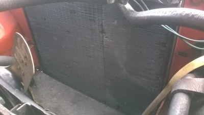

The profile of the rad looks normal,just a strange set up with the fins,unless it is due to reconditioning of some sort.
I don't get what the additional fan on the water pump pulley is doing! Is it being used in place of the spacer ring that holds the pulley in place. It would distort if the bolts were just used to fix the pulley to the flange on the water pump + the bolts would be too long.

Vic's resurrection of this thread prompted me to reply to this radiator question from Dave (long since resolved I suspect).
The division in the rad core is typical of a Serck Marston recored radiator - looks exactly like mine!
I guess if they didn't have a core to fit exactly they could simply make some sections fit, works fine.

Only resolved due to the fact that due to the virus, I am not doing much driving in traffic conditions that induce overheating. However I still think that the cooling is marginal. For example, if parked up having a chat with the engine running, it is only 2 or 3 minutes before the gauge starts to rise, and the fan cuts in, whereas I can let my Cortina tick over for ages without any indication that things are getting warmer.Ian Fozzard wrote: Thu Nov 19, 2020 9:12 am WP_20190426_002.jpg
