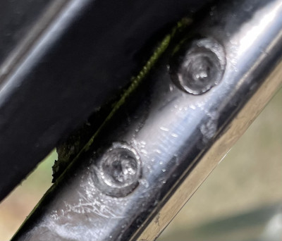

I was able to drill out the rivets holding the lower ‘female’ part of the hinge with relative ease. However the rivets holding (what remains of) the upper ‘male’ hinge have defeated both my original drill pieces and the replacements I bought today at a high street DIY store. As you’ll see with the attachment, I’ve made some progress. However the drill pieces can’t seem to cut further and I draw the line at the hole beginning to glow (momentarily) with heat.
Has anyone had a similar experience and found a solution? Do I need a particular type of drill bit? I’ve read elsewhere that sometimes previous owners have used spot welds instead of rivets and that those are particularly tough to remove? I’d swear I was dealing with rivets, not welds, but I’m far from being an expert.

I cannot see exactly whatthis is attached to. But if the hardened pin is still in situe, that may stop your bit.
If there is nothing be hind the rivet I would tap something like a pin nail through the centre.
I'm no expert either, but from past experience the metal pin that breaks is usually hardened.

Paul - I must admit I’d hoped I’d be able to get the rivets out without removing the glass behind them, so going for them from the other side isn’t an option for now. Assuming another solution doesn’t appear soon though… I may have to lean how to remove and refit the glass and get in behind as you suggest.

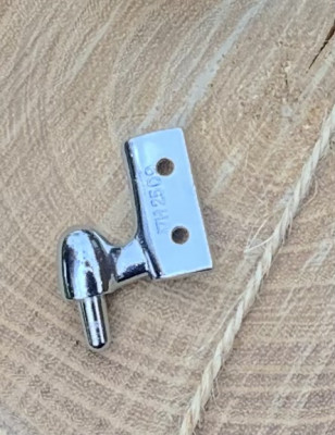

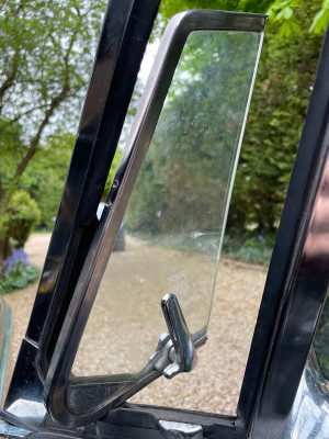

For reference… I’ve attached a photo of the wider area of the quarter light - just to elaborate where I am working. I’ve also attached a photo of the replacement hinge part.

I would say the glass will have to be removed or it will break anyway. As soon as the rivet centre moves the glass is going to get hit.
I'm sure the glass will need to be removed to not only getting out the old rivets, but to install the new ones. The new rivets will need to be the correct length so they do not touch the glass.

Anyhows: I think Paul Scott’s hit the rivet on the head so to speak. The only solution appears to be removing the glass and pushing the rivets out from within the frame. Given that takes me into unfamiliar territory (removing and refitting glass), I think I’ll save the job for the long 4 day weekend in June when I can take my time
