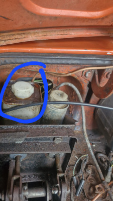

Hi recently got an mgb..the brakes are treadful i renewed the front brakes but they keep collapsing. So next step is the brake servo. Im just double checking if the servo is piped up correctly. Thanks

I think that looks OK, but there are a few questions:
#what do you mean by "collapsing"?
# what did you renew so far?
# that master cylinder looks ancient and may need replacing
#the airline to the servo also looks very iffy, and has perhaps been disturbed recently?
I would probably start with that master cylinder unless you have refreshed it already

Thanks for the reply. You have replaced that servo since you took the photos I guess?

Well, some of that piping ( and other things ) looks rather messy, but ...
I'm not familiar with the layouts on the various 1800 versions, and a quick search isn't finding much.
Can you post any further picture(s) of the piping layout ?
Ideally to join up the two you have so we can see what connects to what/where.
Particularly between the master cylinder and the servo.
