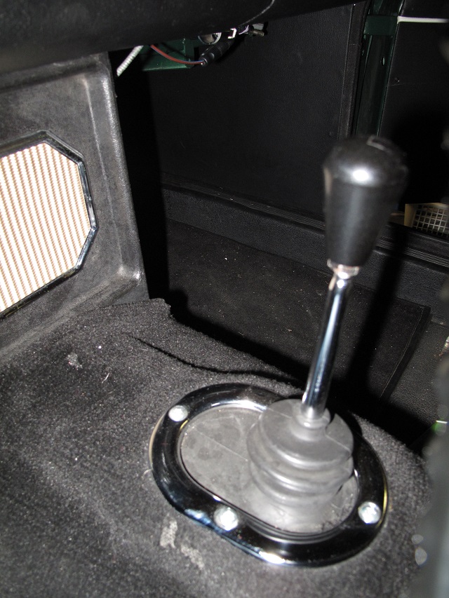

Here is a picture of a 3 synchromesh tunnel with overdrive.
The 3 sync gaiter and escutcheon are oval in shape.
If this car was non overdrive, the gaiter would be reversed and the gearstick would be cranked towards the rear.

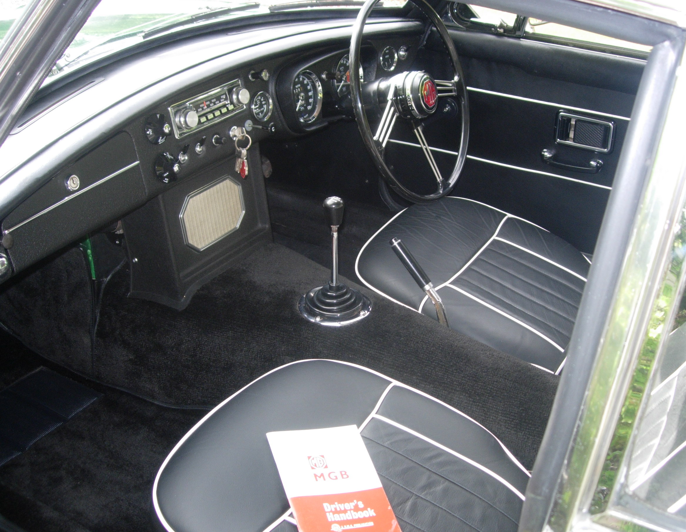

This picture shows the 4 synchromesh gearbox tunnel.
Note the shape of the gaiter and escutcheon. They are now round and not oval.
You can compare the different tunnel shape particularly on the bottom of the speaker facia.
