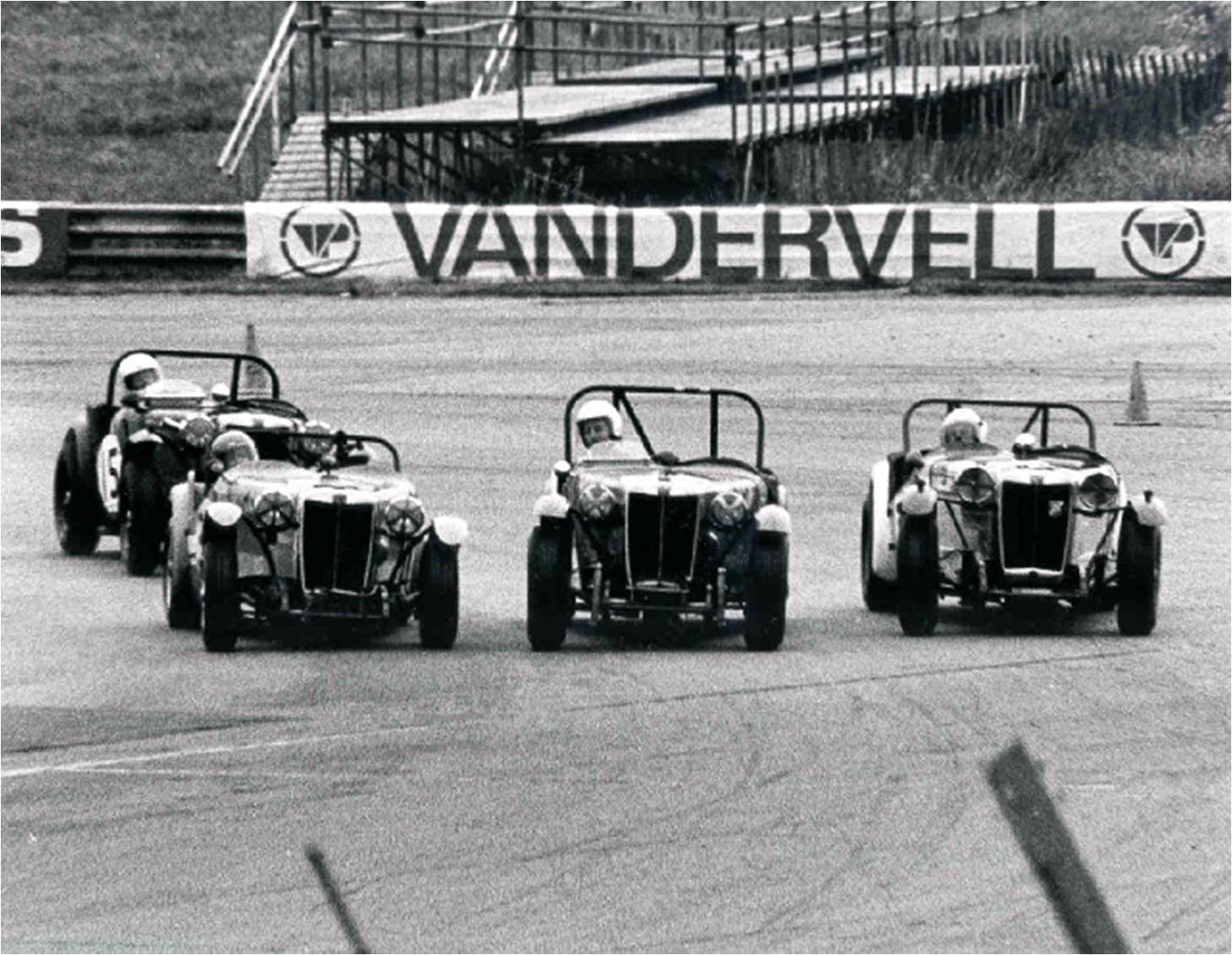

Handling is a very subjective term rather than being objective. Fitting different springs, dampers, antiroll bars, bushes, etc are all objective, but the handling is the way the car feels to someone when they are driving it. So what I think is a nice handling car might be a nightmare for someone else, and since no two people drive in exactly the same way, what suits one driver might not suit another. This why when Hamilton is a little off the pace in qualifying compared to Rosberg, they can't just set up his car with the same setting as Rosberg uses. Because I've done a fair bit of racing both on circuits and sprints and hillclimbs means I like a car that has a sharp turn in so I like some negative camber at the front and higher tyre pressures at the front to help this. I also like to sit low in the car so I can feel the handling early. These are examples of what is termed 'handling'.
This picture shows what I mean, taken at Silverstone in 1975 during the T-type race. The 4 cars in the picture all set the same lap times, but look at the 3 cars in front. I'm on the left, and my car is fairly neutral and rolls quite a bit. In the centre is Gerry Brown, whose car oversteered a bit, and on the right is Dave Clewley who is understeering. Three setups, three different handling cars, three drivers with different driving styles. Chris Jones (No15) won the race!
[attachment=0]TC Race at Silverstone.png.jpg[/attachment]
