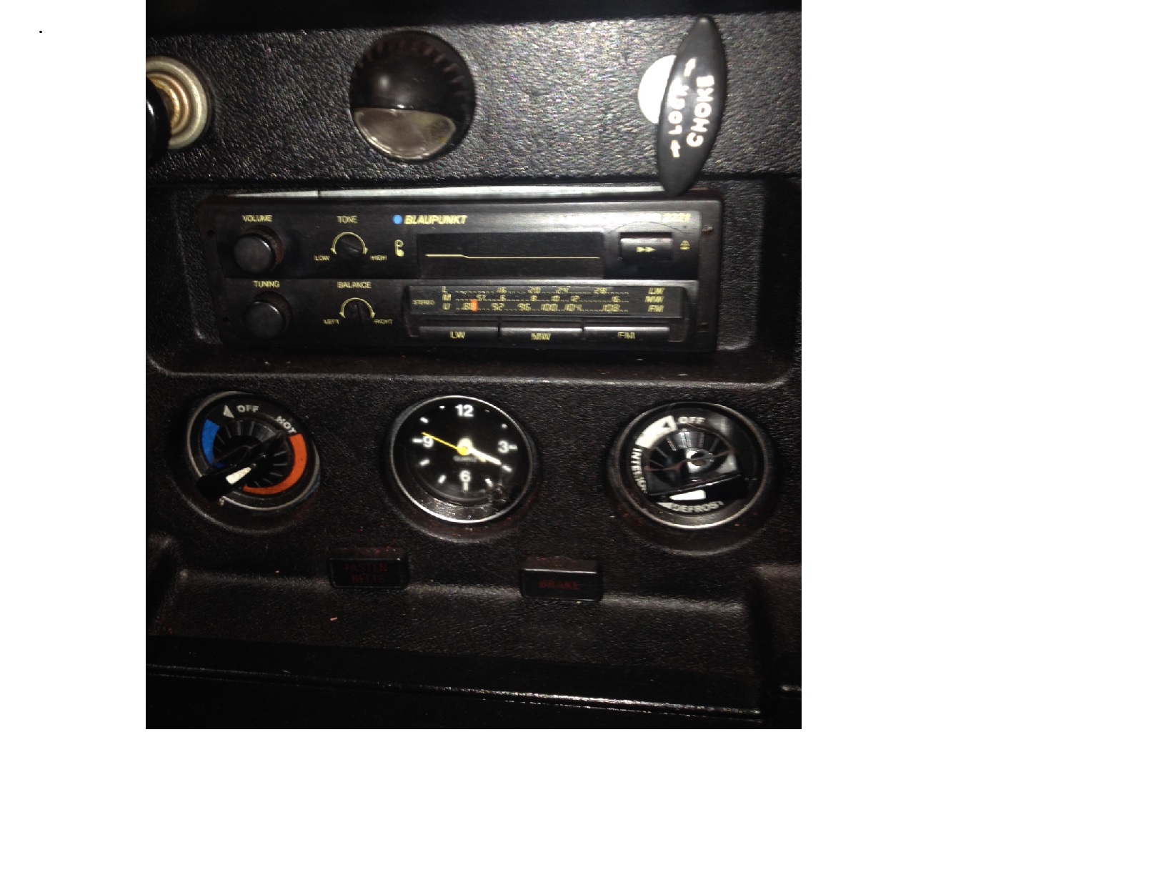

So back from hols now, managed to spend an hour so far replacing spark plugs and fitting my spare Moto Lita (on basis i've found out the SAAB branded one currently on the B could be worth some money!). Anyone else got a working 80s Blaupunkt R/C in their cars - mine looks like the sought after 80s BMW fitted units.............?
[attachment=0]MGB Blaupunkt.jpg[/attachment]
Still no fuel coming through (pump sounds like a drill now) - definitely sparking as I have tester for that!. Will jack car up and see what comes out when pump pipes disconnected, at least that's an easy refit! Minilites arrived, just got to sort fitting tyres.
