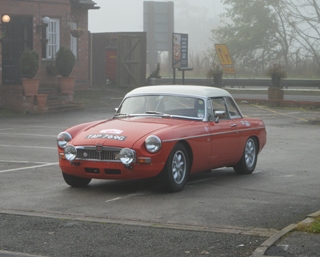

I now have the proper Works hard top (identified by having square corners at the bottom of the rear window and having very slender aluminium window frames for the side windows) which has rear mountings that slot into the rear hood mountings and it also has over centre catches to clip it to the windscreen frame. The sides mount onto brackets which most suppliers sell (but they are more expensive than you think they might be!) by using the 3 screw holes the the side mountings for the hood plates. I did briefly try to keep the hood attached to the car, but found either the hood fitted and not the hard top or the other way round. Having read the owners handbook, I removed the hood completely and then eveything fits ok. This also gives you bags of space behind the seats.
The attached picture will help you to indentify a genuine Works hardtop, which is fitted to my car and shows the square bottom corners and the slender side window frames. There shoud be a chome locking strip around the rear screen rubber which is missing at present.
To my mind the only hardtop that looks right on an MGB (or Midget for that matter) is the Works one and they are well worth seeking out. They turn up on ebay quite often and that is where I purchased mine.
I think it is quite rare to have a foldaway hood on a 1962 car. Perhaps others can clarify if this is so, or has the foldaway hood been added later. They are more convenient, but you don't get the purity of the design like you do with the hood that has separate sticks and fabric and comes off the car completely when you put it down.

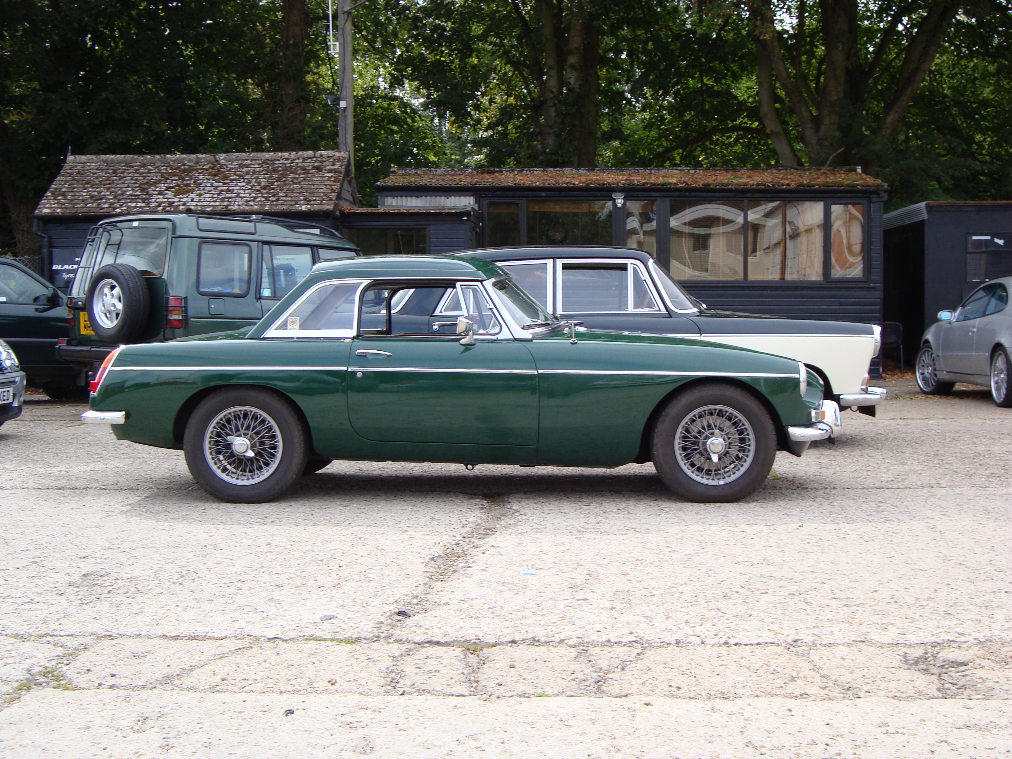

My hardtop is a genuine works hard top made by Watsoninan Sidecars, the second firm that made them for BMC/MG Factory - see the Clausager book for fuller details on manufacture.
I believe the tooling is now in the USA with The Roadster Factory not that they have ever made any.
Mine looks just like Pete's hard top except it is body coloured.
It came with the car when I brought back it in 1984 already painted BRG as the per the car.
None of the "works style" hardtops as per Moss and MGOC etc in my opinion look as good as the original.

Here is a picture of my car with Works hardtop leaving the start of our natters recent Autumn Tour. Old English white with red looks fantastic - I think!
It is always worth checking with sellers to see if they have the fitting brackets, as a these cost around £50 to buy separately. Since your car is a early one, it might use a rail to support the tonneau cover, in which case you will just need the L shaped brackets to connect the hardtop to the car. If not you will the triangular slot brackets as well.
Go to ebay and do a serach for 'MGB Hardtop'.

Suppose I ought to add a photo of mine - the all green car- only can find a side view at present
