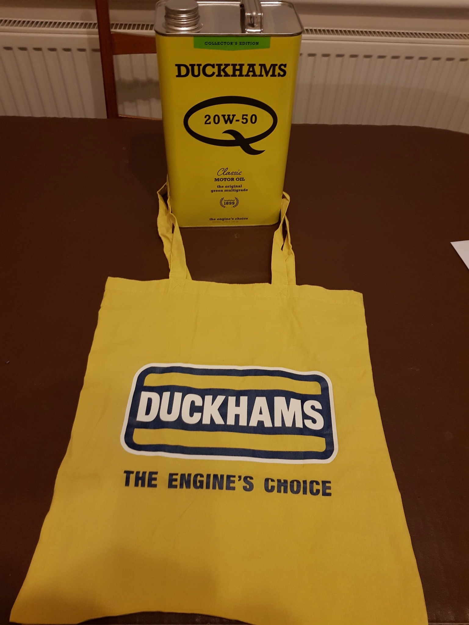

[attachment=0]IMG_0381.jpg[/attachment]
Bought from Duckhams website below
https://www.duckhams.com
Rob
Rob

Thanks gentlemen...all most helpful and food for thought. So you CAN get Duckhams then !

Two great recommendations for good quality oils - Castrol XL 20-50 and Duckhams Q20-50. Both have good levels of ZDDP.
