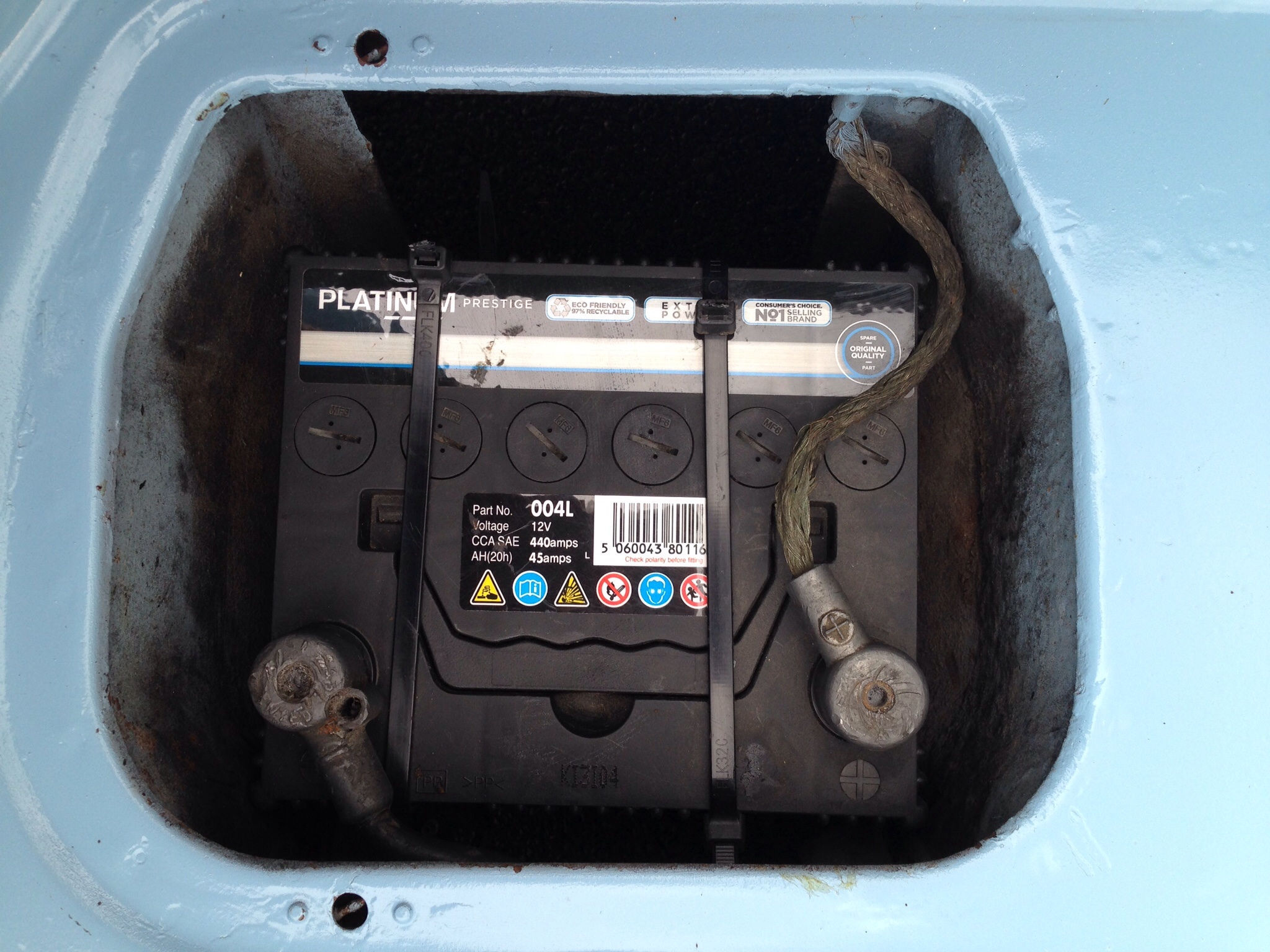

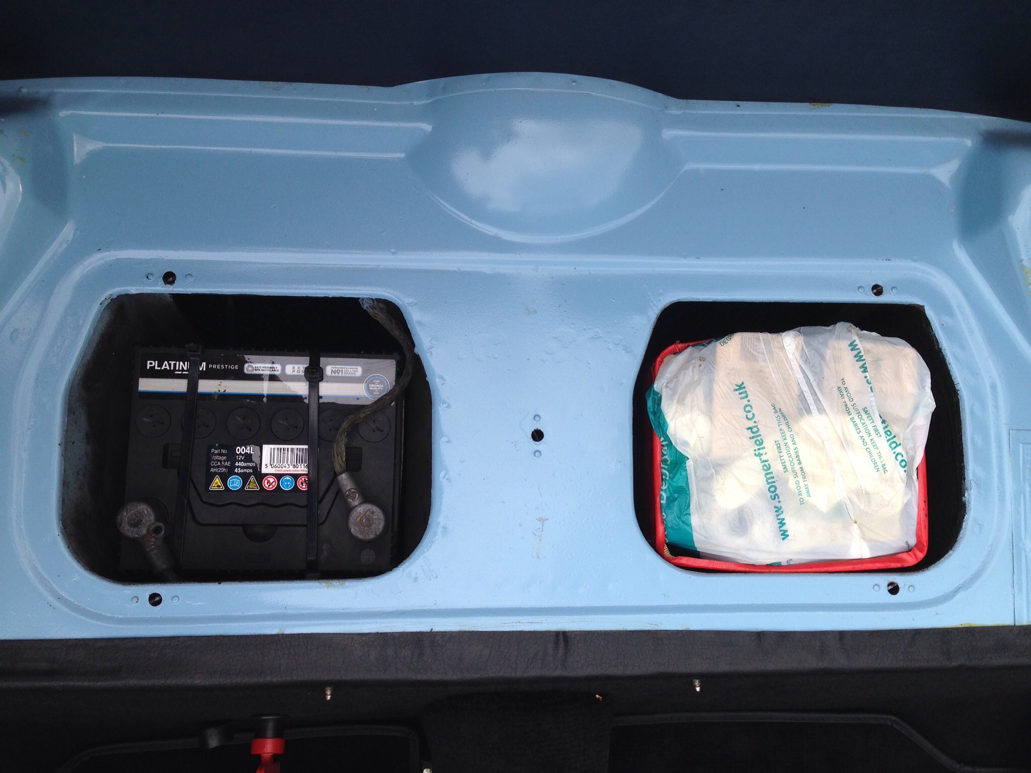

Re: Batteries
Here are some pictures of my battery installation, the empty compartments carries a selection of spares in a waterproof box, these are available from Moss Europe
- image.jpg (683.21 KiB) Viewed 50425 times
- image.jpg (800.37 KiB) Viewed 50425 times

Re Davids comment about a use for the empty space having now only got one battery - i think you can buy a storage 'bucket' that can be used to keep tools etc in. Very handy.
