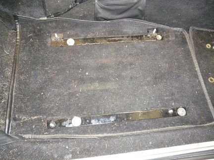

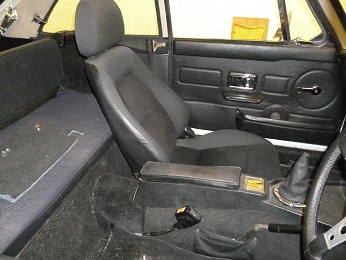

Here are some ramblings: -
I have fitted MX5 seats to my MGB GT. They were from a late Mk1 (approx 1994 to 1998) with separate headrests and look like they were made for an MGB GT. I do not know whether the Mk2 seats are the same. The early Mk1 seats are a different style with fixed headrests with their own speakers. "My" seats have a slimmer back rest to the MGB's.
I made-up some adapter plates and used the original 'B' mounting points. I have attached scans of my working sketches (hope these notes are not too jumbled) and a photo of the driver's-side plates. The plates are made from (1/8" thick, I think) strip steel and extra 'tabs' have been welded to pick up the seat mountings. It's a simple mod but took quite a while to get the optimum solution. The original MGB mounts use 1/4 inch UNF sets and the mx5 uses larger studs which are welded to the adapter plate - using any diameter or thread type of your choice which goes through the seat holes! Other people have used wider steel strips but this is not necessary if you have access to a welder. I have used the Mazda slider mechanism, it being superior to the MG system but you will need to bend the front mountings of the seats to provide a flat fixing to the adapter plates. This is easy and they can be cold bent. I have used MGB exhaust manifold thick (slightly domed) washers over the original front MGB sets for neatness.
The original MX5 seat belt mountings are attached to the Mazda seats hence the Mazda required stronger seat fixings, but I have used the original MGB seat belt arrangement, hence the seat assemblies take virtually no anchorage stresses (just like the original MGB). It's a bit awkward and hard work to remove the seat belt mountings from the seat frames (by cutting disc) but worth it.
The driver's and passenger's side seat assemblies are slightly different so will require slightly different fitting arrangements. I chose to use both seats in the same orientation in order that the back tilting operating levers were located on the door sides, handy for accessing the rear of the seats from outside the car. On my car (1972 GT) there is a slightly reduced fore & aft adjustment ability because of the wider transmission tunnel I suppose, but still OK. Is your '69 car a narrow tunnel type? It would make it easier if it is.
The whole modified system is reversible to original within half an hour total for both sides.
No need to use the wooden strips of the original seat fixings.
The seat height appears to be about the same as original.
I only went this route because my seats needed rebuilding and the MX5 seats were much cheaper and are in excellent condition, but they are supremely comfortable and also hold you well. I am very pleased with this worthwhile mod. Re-covering kits in leather etc. are readily available for the MX5 seats.
I am not sure whether an MX5 seat conversion in an MGB roadster would look as pleasing as the GT conversion, but hey, that's an individual subjective decision.
It may be that re-covering your original seats with a modern automotive cloth could hold you better and along with a lumber plate modification and new foams would be more comfortable.
Hope this has helped make a decision!

I have now managed to reduce photo size and have attached one of the strips and a general view of the passenger MX5 seat.
Please refer to my earlier post for the details.

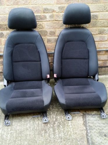

Hi Richard,
Hopefully you will pick this up in time!
Do these seats look like yours? These are from an early Mk2, which I believe to be much the same as a Mk1 but without the pop-up headlights. George if you see this perhaps you can prompt Richard.
