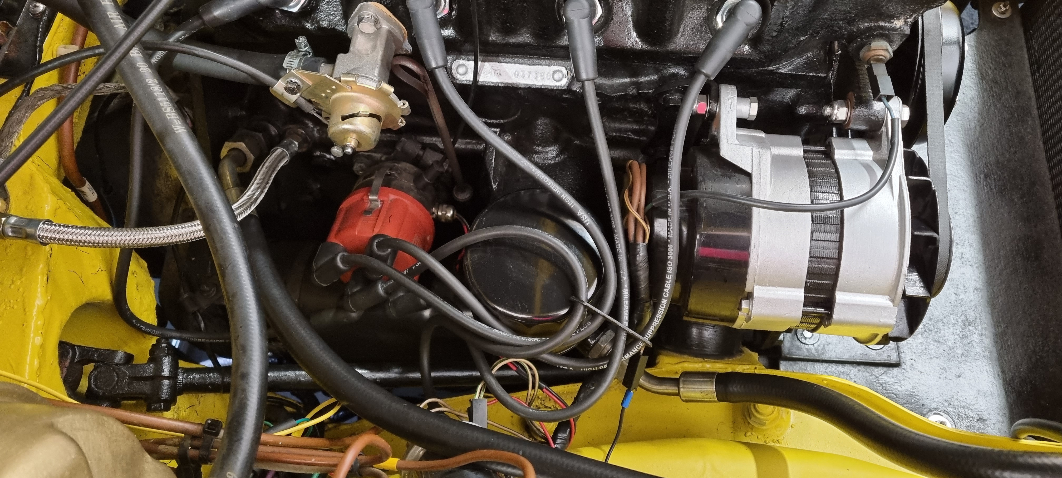

Hi Alun,
See picture for ref purposes of fitted 123 - no additional boxes to fit - i appreciate costs need to be taken into consideration.
Cheers
Charles
Cheers
Charles
