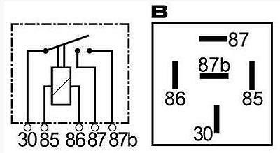

I took another look at the wiring diagram and Charles is correct .The 6v from the coil would still be connected to the solenoid during normal running. The addition of a diode would sort this (Readily available from RS). but after looking at a simpler solution I came across this relay that may work and would be an easy swap with existing starter relay.
https://www.12voltplanet.co.uk/make-and ... 0-amp.html
There is that has a double output pins. See attachment. The wire from the solenoid could be connected to pin 87 and the wire from the coil to 87A. When the ignition switch it turned the start position 12 will be applied to both the solenoid and the coil then when released because they the relay contacts are isolated from each other there will be no voltage feedback from the coil to the solenoid during normal running conditions. Could be a cheap and simple solution to the replacement RB starter motor issue.
Best regards
Mike Barclay

Michael. That relay might be just the thing, considering that I do not appear to have a 12v supply to the coil during cranking. I'm going to check out the 2 relays and wiring tomorrow.
