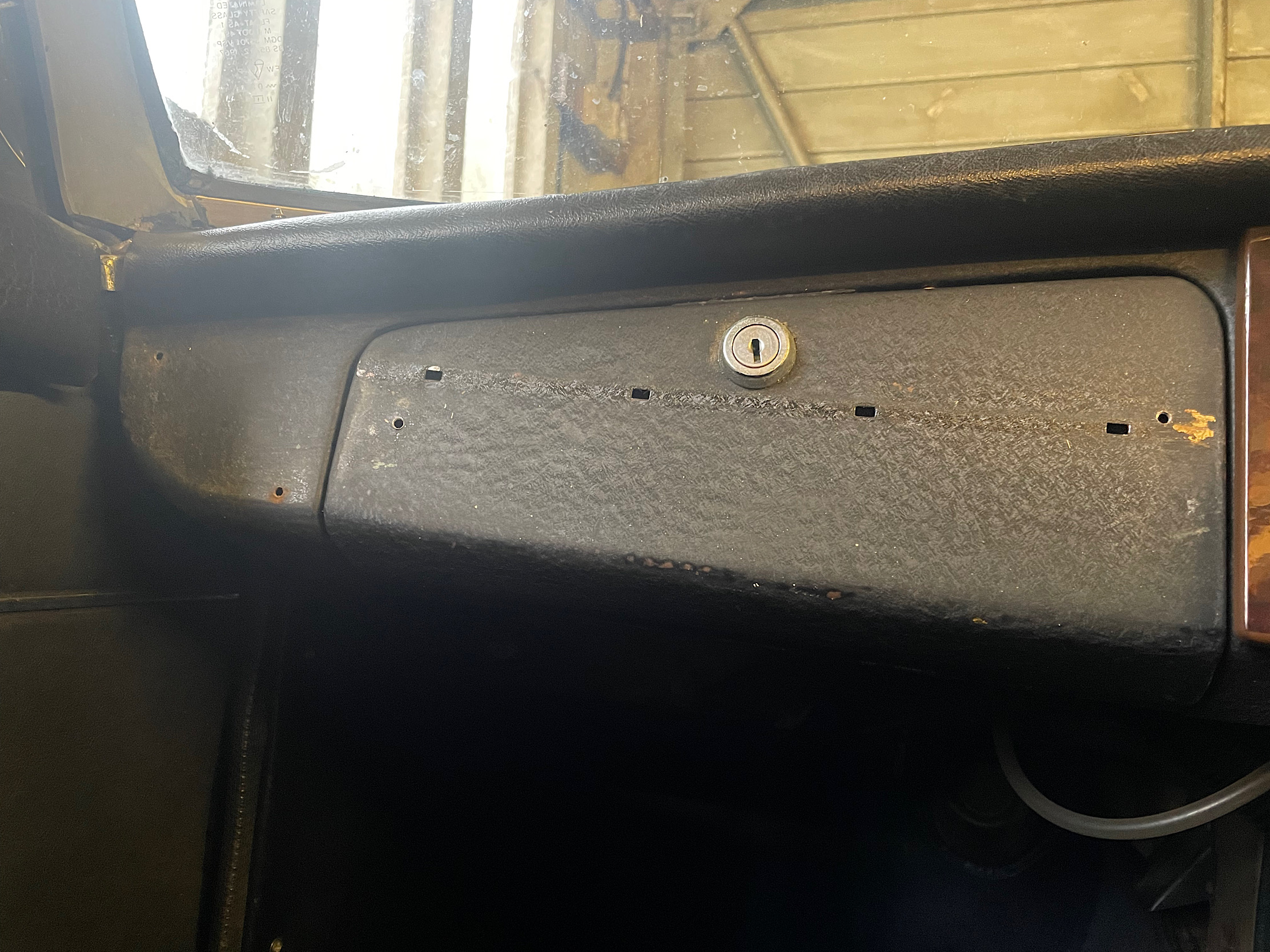

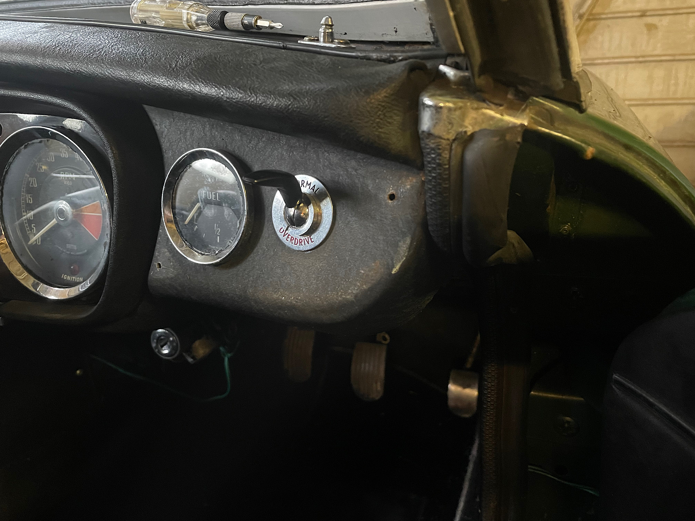

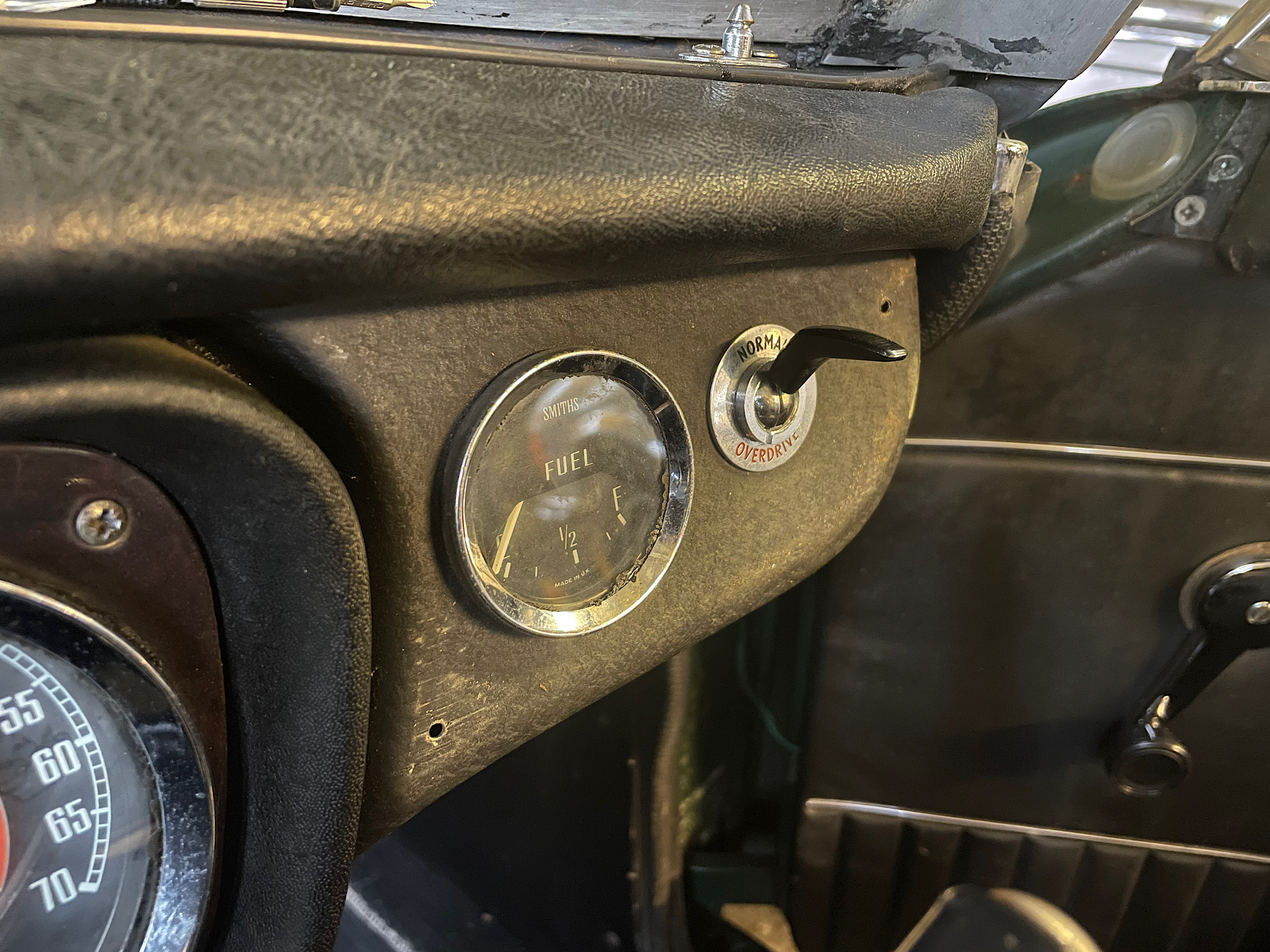

Just as an update (as per the ask earlier in the thread)…. I finally made it back to the UK and got an opportunity to take off the wood veneer. As Ian predicted, the Dashboard has incurred a degree of damage to the paintwork as you can see in the photos below (although far less then I was expecting).
Mulling my next steps now, but my guess (very happy to be corrected) at this point is that the Dashboard would need to be removed in order to properly repair the paintwork.
My only question at this point is that the crinkle effect on the dashboard (such as it is) appears subdued compared to what I’ve seen on other cars in original or restored condition? Is it just that actually the damage to my dashboard is more extensive then it looks, or is it that the crinkle effect is overdone in some restorations?

Hi David. Depending on what standards you are setting, I think that dash could be made presentable in situ.
The gauges are easily removed (care required with the temperature capillary) and certainly easier than taking out the whole dash. Then with filling the holes with epoxy, careful masking, you could respray with crinkle finish paint.
I have used crinkle finish paint myself, and have to confess with some difficulties. But It is possible to get a good result. What I found was that the crinkle effect from the paint is quite pronounced and very glossy, so you would loose that patina if that concerned you.
The good news is that if it didn't come up to your expectations then you are halfway to taking the dash out already! They can be refurbished professionally but I don't think they are available new. Much to be preferred over walnut though (in my opinion of course
P.s. if removing the steering wheel take care. If it is of the collapsible or semi collapsible type you can easily destroy the collapsing component. Make up a puller to do the job, do NOT whack it with a BFH!!

The rectangular holes on the glove box lid are where a chrome strip is supposed to be mounted. So don't fill those in if you want to reinstate the strip.
