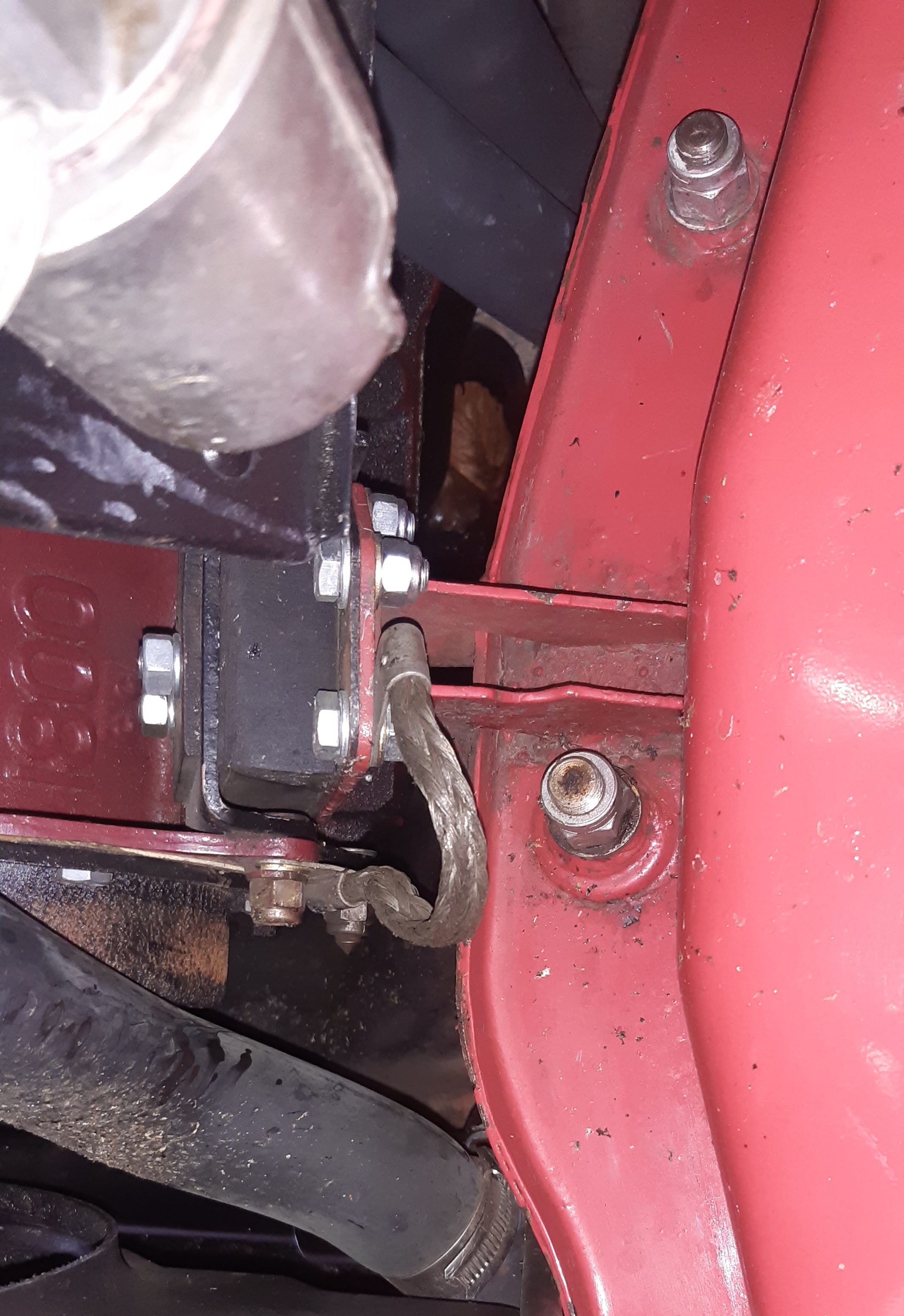

Re: Starting problems
The main earth for the starter motor, is on the left hand side (nearside in the UK) of the engine and connects the front mounting plate of the engine to the body side of the engine mount. This picture shows the arrangement:
The usual issue that stops this working is the braided strap frays and has too high resistance or over zealous painting of the engine plate or mounting to body. Both these areas have to be paint free, and clean. The faces the starter motor bolts to must be clean and dry also. This is especially important if changing the starter motor on an engine that has seen a lot of service and is oily in the this area.
I don't think adding a strap from the gearbox crossmember centre bolts will help the issue as the gearbox doesn't have a metal to metal contact and the crossmember has 4 bolts connecting it to the body anyway.
