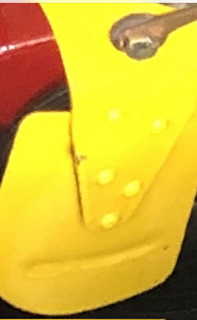

Re: Broken fan blade.
I can't check my metal fan at the present time, but are the blades rivetted on? I did wonder if it was the rivets which had failed or a failure of the metal blade itself?
If rivetted, I guess failure of the blade around the rivet holes is most likely?

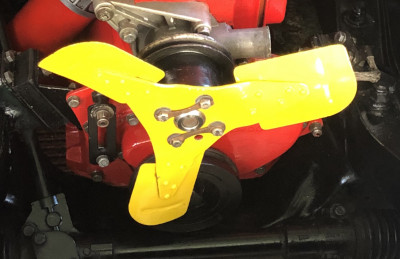

My 3 bladed fan is riveted-
- IMG_7980.jpeg (15.32 KiB) Viewed 137356 times

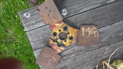

Here's a pic of the broken fan.
I hadn't noticed before, but it appears to have been messed about with.
It#s 3 bladed not 4 bladed.
Looks like you have some additional holes drilled there, wonder if that has weakened the fan blades resulting in the eventual shearing?.
