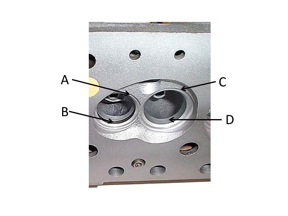

Unfortunately, the only way to be sure that a head has been converted to run on unleaded fuel is to take the head off and examine it. This picture should help with your identification.
[attachment=0]Unleaded Head.jpg[/attachment]
Only the exhaust valve seat needs to be converted with hardened seats, unless the inlet valve seats have recessed badly and those have been done as well to recover the head.
At point A you will see a distinct machining mark, where the head has been cut to accept the new seat. If the head has been polished (as in a stage 2 head), this will be less distinct, but your should see a feint circle line of larger diameter around than the valve). It might need a bit of a clean up with a rotary wire brush (wear goggles) so you can see clearly.
At point B you can see the new insert in place down the valve throat. You can't see this unless you take the valve out, but the marks around the valve at point A will suffice.
Points C and D show an unconverted valve seat, in this case the inlet.
There is rumour that very late Marina 1.8 heads were unleaded, but I've not seen this substantiated so personally I doubt this, and in any case they are likely to be much rarer than an MGB head.
If you don't want to take the head off, then assume it is a leaded head and use an additive. I prefer Castrol Valvemaster to many of the others as you only need a small amount per fill up. Some you put in the whole bottle per fill up.
A final thought is that if only do a small mileage a year and/or don't use high rpm, an unconverted head seems to be fine for 10,000 - 15,000 miles without using an additive. You do need to check valve clearances more frequently, particularly if the engine seems to be running quieter (less tappet!), to check they are not closing up. This is a sign of valve regression where the valve is rapidly wearing the valve seat away.
