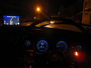

Finally had LED bulbs fitted to dashboard. There is a distinct improvement to readability of instruments but light levels not stupidly bright. Original fuel guage, which is lit from the side rather than from within the instrument, is the one which is still the most dim- markedly better than previously. No need to bypass the rheostat on/ off switch either.

Fitted LED bulbs to instruments in September. Effect is brilliant, LED bulbs differ in throw capability etc. Mine were from USA source. No longer an issue now but be aware LED bulbs don't dim via the rheostat without special wiring which I didn't bother with since never dimmed the instruments bulbs anyway.

My Dash instrument LED bulbs were sourced from:
Veloce Solutions.
Joe Parlanti,
16048 Copne Meadow Drive,
North Potomac.Md 20878
USA
Email: [email protected]
Not expensive and quick service to UK.
They have an excellent spread of illumination.

- LED Instrument Bulbs
- P9280454 (300x225).jpg (54.52 KiB) Viewed 38707 times
Living life in The Hebrides since 1990
